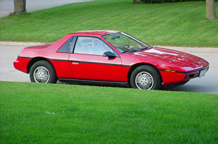

Thanks for the advice Gold, I should have mentioned that I put a rod through the pan...
I've worked on engines before, and I just need a couple of examples of the cars that I could pull one out of. Every mechanic I talked to says it HAS to be out of a Fiero. I looked at the Cave and I at least know that nearly any 86 or before will work. Now I just have to find one a poor college student can afford.
Here's a pic:

Originally posted by Jake!:
Nice Fiero. With some luck you'll have her on the road in no time.
BTW, a little over a year ago I bought a Duke from an 85 Fiero for 125 bucks. I put very little additional money into the engine and I was on the road while I rebuilt the 84 Duke. My purpose of the post, you can good deals. Best of Luck.
