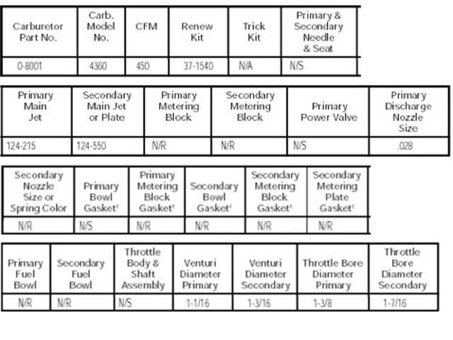

Got this from www.holley.com

I wonder if the 8001 thing makes a difference to 8000-1

Oops! I screwed up. I can't find your list number in the numerical reference. Sorry. Give Holley a call at(502) 781-9741
