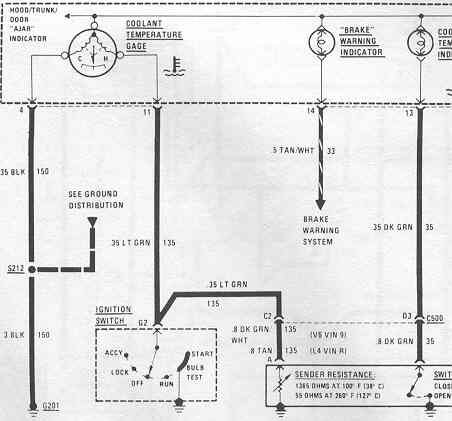

I FOUND IT I FOUND IT!! Took me 20 dam minuts but I hope it is what you were looking for

Thanks for the effort red85gt, but I don't see it on your picture, maybe it's the other half? I do see C2 and D3 on the C500 connector.

it was the only light green wire that I could find in my manual that went to the c500 connect.
