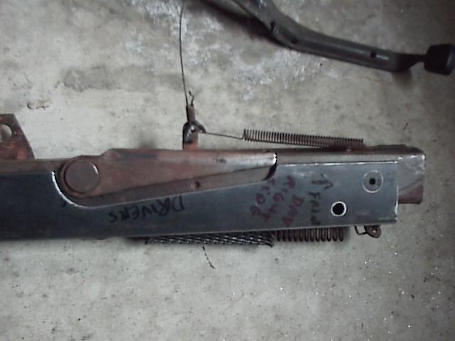

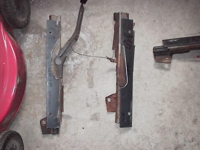

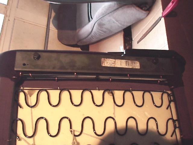

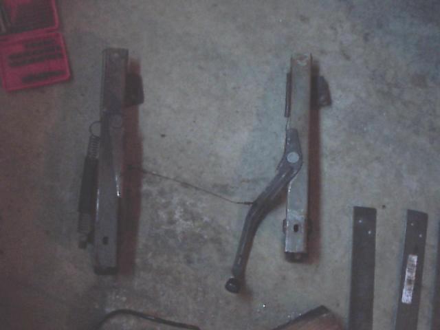

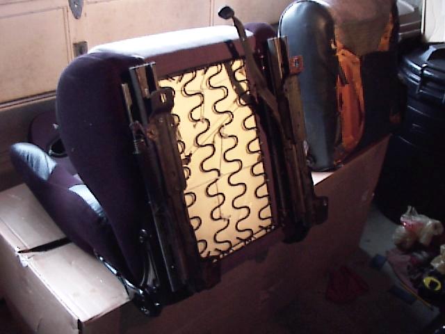

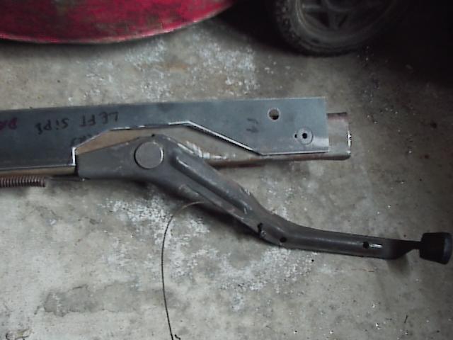

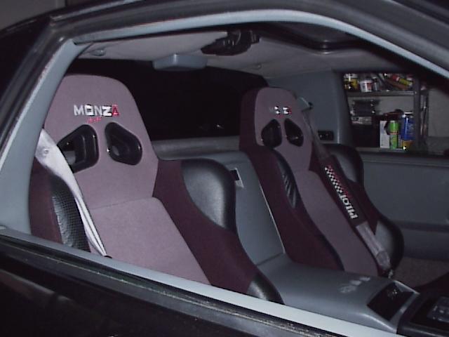

It's a good thing that I measured the stock seats and choose a replacement that was very similar in size. Let me tell you that it sure was a squeze fitting the new seats in, actually the new seat since I only did the drivers side today. Tomorrow I will install the passenger side and it should go in a lot quicker. OK on to the install. First I mounted the new seats to the factory seat tracks. Why did I do that, it was the fastest and easiest way to do this. I used some flat stock that I bought at home depot. It was 2" wide by 36" long. I cut it to two 16" lengths. This is going to adapt the new seat to the old tracks. . Next I removed the old tracks from the stock seats. The adapters get mounted to the new seat with spacers. Followed by the tracks with more spacers to clear the bolts that hold the adapters. Eventually I will get countersunk screws to help lower the whole thing, but this will work for now. Now it's a matter of contorting the seats into the car and squeezing it to get the tracks mounted onto the studs. Here are a couple of pictures of the final product. Remember, measure twice cut once. You will notice that the new seat is a bit taller than the stock seat.

The seats I got from Ebay. They are Monza brand and are supposed to be made in Australia. I spent less than $30 in the items needed to adapt the new seats to the stock seat racks. I just measured the distance between the bolt holes in the new and old seats and made the adapter brackets so that the seats would be centered on them. I could have offset the holes to give me some more side room, but it was a tight fit. I saw some other seats for sale on Ebay but they had even higher backs to them. I wanted a pair of seats that would fit in the stock location with the stock seat tracks. The new seats did come with their own seat tracks, that are very nice, but they would not work with the stock mounting studs in the Fiero. The studs aren't even in a square configuration like the new seats. The back studs are offset to the left. I also didn't want to have to drive holes in the pan to mount the new seats. Liked mentioned above, I too saw the mounting kits they sell and decided to just make my own. I decided they weren't worth the price, and fabricating mine didn't take more than an hour, plus I didn't have to wait for them to come in. I have no plans for a harness yet, maybe some time in the future.

Yeah, a new headliner is on my list of projects. I even have the stuff to do it, just haven't gotten around to it yet. The new seats do feel like you sit higher and with the spacers I had to use they are about an inch higher than they should be. I have to get some countersunk bolts to fix that, but for now this will work.

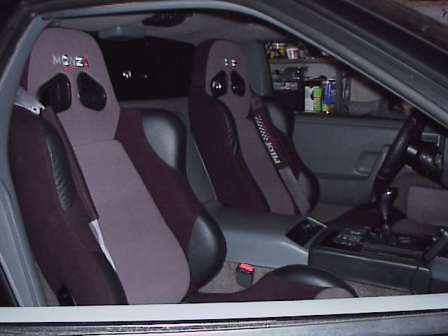

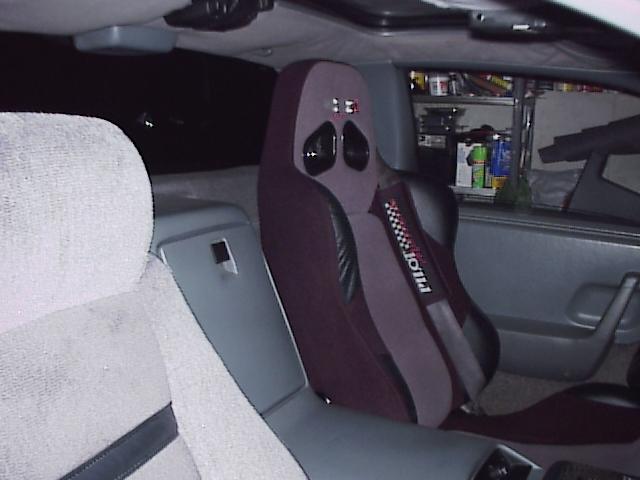

Here's a final picture. What do you guy's think of the end results?

that looks really good!

man those seats look really really tall....

Got very simmilar seat to those in my 88 they to were from aus and go by the name of "Auto Technica" [still made in china though]They also sat very high so i had to take the runners off and bolt the directly to the floor then they ended up the right hieght but it wuz one hell of a job to get them in the right position as you only get one chance to drill holes. They look and feel great though. i'm now in the process of adding 3 point harnesses

Mine are bolted to the stock Fiero seat rails. I wanted to do it this way in case I decide to go back to the old seats. Right now I have about 1" of spacers to fit them to the rails, but I will be able to get rid of this with some special head bolts and some notching out of the adapter brackets I made. These seats have a thicker foam bottom that the stock Fiero seats. I kind of like the higher driving position, and I still fit in the car with plently of head room. The backrest on the new seats is also at 4 inches taller than the stock seats.

In the last picture you can see my stock seatbelts with "Pilot" shoulder pads. I am lowering the seats today as I finally got the right hardware and can now eliminate all the spacers. I will post some pictures later of the modified adapter brackets. The seats are actually Black and Grey in color, I guess the flash makes them look a different color.

Report this Post06-03-2003 07:04 PM Click Here to See the Profile for avengador1Send a Private Message to avengador1Direct Link to This Post
avengador1
35468 posts
Member since Oct 2001
Here's a final picture of the brackets and how the seats look mounted flat on the stock rails.
The White marks on the center console are my attempt to fix some burns my son made with the cigarette lighter. Needeless to say he doesn't have any more video games to play for the whole week.
