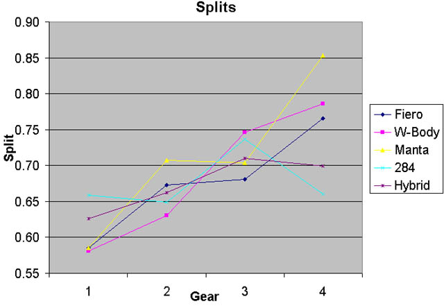

I just found this website http://www.brian89gp.com/other/transmission.htm and discovered that W-bodies with the 282 Getrag had a different gearset than everyone else. Presumably this is because the W-body is a pretty heavy car for an anemic POS little 2.8 or 3.1 and they wanted to give it some semblance of acceleration. I haven't found the RPO for the W-body trans yet.
The ratios, along with the performance gearing from www.mantapart.com are tabulated here:
code:
Trans 1st 2nd 3rd 4th 5th
MG2 (Fiero) 3.50 2.05 1.38 0.94 0.72
W-body 3.77 2.19 1.38 1.02 0.81
Mantapart 3.50 2.05 1.38 1.02 0.87
Here are the splits (percent of shift RPM the engine's turning after the shift):
code:
Trans 1-2 2-3 3-4 4-5
MG2 (Fiero) 0.59 0.67 0.68 0.77
W-body 0.58 0.63 0.74 0.79
Mantapart 0.59 0.67 0.74 0.85
Notice that the 1-2 splits are very low for all gear sets. This translates to a large RPM drop and a huge gap between 1st and 2nd. I know that I think that gap is way too big and I've heard a lot of other people complaining about it also.
Now, if we take the Fiero 1st & 5th, the W-body 2nd, 3rd & 4th, look at what we get:
code:
Hybrid Ratios 3.50 2.19 1.38 1.02 0.72
Splits 0.63 0.63 0.74 0.70
Notice that the 1-2 split goes from 0.59 to 0.63, which is a very good improvement. In my case with stock trans and a 6400 RPM shift, I end up at 3,776 in 2nd gear, which is a little below my power band (4400 TQ peak). With the hybrid gearing I end up at 4,032 RPM in 2nd. This sounds very nice to me because I currently feel like I have to shift on the rev limiter in order to get a decent pull once I shift into 2nd. Another benefit is that the 1-2 shift will be faster because the 2nd gear synchro doesn't have to overcome as large an RPM difference as it does with the stock gears.
The 2-3 split unfortunately widens from 0.67 to 0.63, but this is exactly the same as the 1-2 split. Since the same 3rd gear is used, you won't lose any pull in 3rd, you'll just gain it in 2nd. A 1.46 3rd gear would be ideal here
The 3-4 split is significantly closer than stock for you insane people who race to REALLY illegal speeds.
The 4-5 split is another place where the hybrid gearing departs significantly from stock. The stock gearing has a very European slant in that 1st is very deep so that a high strung engine can get the car moving, 2-3-4 are tallish with even split (road racing gears), and 5th is very close to 4th so that a small engine trying to maintain Autobahn speeds has a prayer of doing so.
By dropping 2nd and 4th the transmission becomes more V8 friendly, with the splits more even across the board. As I said before, a 1.46 3rd gear would be ideal, but is unfortunately not available. If you keep the Fiero 4th you get a smoother progression of splits, but I'd rather have the 1.02 4th for better acceleration.
Since you'd be using the Fiero 5th gear, you don't sacrifice any highway RPM for the benefits of much nicer gearing.
The SBC guys would probably want to keep the 3.61 final drive of the Fiero trans. For my Northstar, I think I'd like the 3.94 final from a Quad 4 transmission (I'm tired of having torqueless imports with final gears well into the 4's keeping up with me to 60 ) I know the 3.94 will increase highway RPM, but it should still be livable (3300 at 90 vs 3000 at 90).

Originally posted by 87GTZ34:
I apologize. I came across a little too strongly. From some of the things you said (high revving?) it sounded like you were talking about the 284 and only the 284. Anyway...
I disagree with you about why the gearing is different. Compare the Fiero gearing with W-body and 284 gearing:
code:
1st 2nd 3rd 4th 5th
Fiero 3.50 2.05 1.38 0.94 0.72
W-body 3.77 2.19 1.38 1.03 0.81
284 3.46 2.28 1.48 1.09 0.72
Splits 1-2 2-3 3-4 4-5
Fiero 0.59 0.67 0.68 0.77
W-body 0.58 0.63 0.75 0.79
284 0.66 0.65 0.74 0.66
Look at the difference. The W-body gearing is even more "European" (small engine, big car), with a slightly wider 1-2, noticeably wider 2-3, narrower 3-4 and 4-5 splits than the Fiero gearing. The W-body gearing starts off with wide splits that decrease dramatically. Why does an engine need such a short jump to top gear? Because it's working hard; small engine, big car. The 2.8 and 3.1 aluminum head engines were not much higher revving than the iron head engines, if at all.
The 284 gearing is much closer to having even splits with a much closer 1-2 split, and the 2-3 split in the same ballpark. The 284 is geared more closely for a higher revving engine, i.e. the TDC, but not the pushrod engines.
The MG2 may have been rare in W-bodies, but it was NOT rare overall, being used in the Fiero, and probably under the same RPO in Cavaliers, Berettas, Corsicas, etc. That wasn't clarified in your first post or on that website.

I've been messing with some gear calculations myself and created a chart to help visualize the RPM vs. MPH on multiple trannies. I added the "hybrid" ratios that Will is considering using the 3.94 final drive.
Comparison Image
If anybody wants to tweak the excel file themselves, here's the document.

Report this Post06-01-2003 02:39 PM Click Here to See the Profile for WillSend a Private Message to WillDirect Link to This Post
Remember that the SCX uses the same gearing as the Fiero, but has the 3.94 FD.
I've e-mailed you my spreadsheet with a chart that illustrates what I'm trying to get across. Could you please .jpg it and post it here? Thanks

Nashco
4144 posts
Member since Dec 2000
Will's gear split chart can be seen here.
