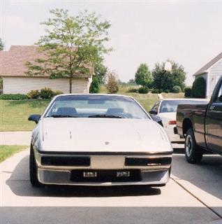

Report this Post05-20-2003 11:02 PM Click Here to See the Profile for HartzSend a Private Message to HartzDirect Link to This Post
Originally posted by jlhuber:
Yall must have some LOW cars.
You might say that...
