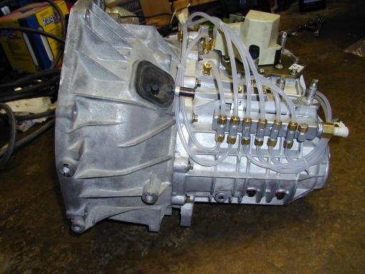

Will, I located a Getrag from an Achieva SCX W-41, I'm using the gearset and LSD. I'm having gussets welded for strength near the bellhousing and the differential carrier.
This is what's called a "Bulldog Box" in the Ford Contour world. The engineer who headed up the CDW-27 powertrain development (Contour, Mystique, Cougar, Mondeo),Terry Haines lives near me. He's now retired and does things like this for Ford products. The lines you see are forcing lube through the bearings and spraying lube on the gears and synchros. The gusseting will be to limit case flex (this suprisingly is what usually destroys gears).
Why? you ask....I'm thinking I'll be at about 8.5:1 compression when I'm done if that's any indication.
Got any sketches? I've been thinking about laser or water jetting a girdle to go around a Getrag at the case seam for a while.

None as of yet, but the girdle idea isn't a bad one. If you had some prints for the Getrag in DWG or DXF format, I could place them where Terry and I were discussing.

No I don't. If I ever break one I'll probably find the motivation to put a case half on a CMM and come up with a print. Until then, since it's not broke, I'm not going to fix it.

The Northstar is pretty large physically. I'm not sure how it compares in weight to the LS1 though.
http://caddyinfo.netgetgoing.com/howto/casehalf.htm
