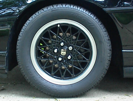

Here are the pics that originally went with the article:
Just after stripping:
After painting:
Final:
