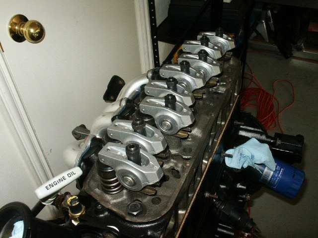

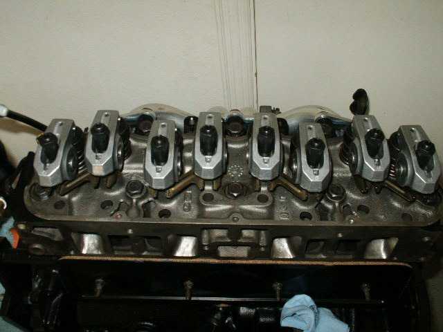

The stock rocker arm ratio on the '84s is 1.75:1. If you want to put roller rockers in your '84 you will have to have some machine work done on your cylinder head. It will have to drilled and retapped to accept studs for the rocker arms. You will also need longer pushrods.
I am using Crane Energizer full roller rocker arms on my engine rebuild. See pics.

T-Top Fiero, are you able to use the stock valve cover, or do you have a SD-4 valve cover? Just curious...

It looks like the stock cover will just fit. The poly-locks are within an 1/8" or so of hitting the top of the cover.
