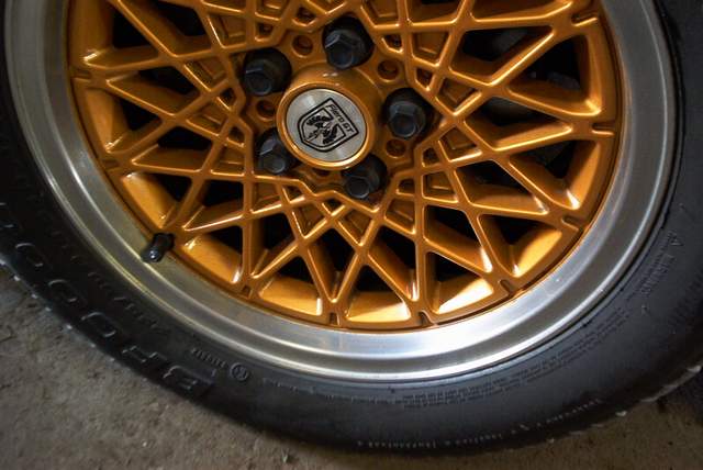

I used paint stripper and stripped the grey off of mine. I stopped when I got to the powder coating, or what ever is under the paint.
Then I had them sprayed at a body shop with automotive paint. The wheels have held up excellent for the past 4 years, except where I have nicked them with the impact gun

Jelly2m8
Your wheels really look nice. I think I might try to trade them for gray ones before I go to the trouble of painting them.
