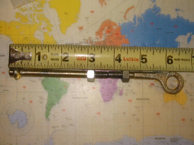

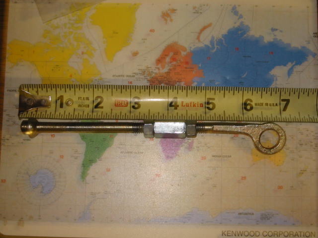

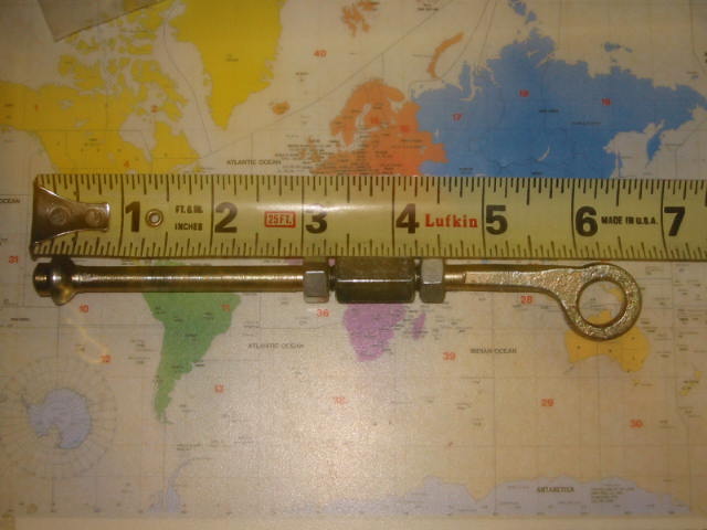

After purchasing aftermarket master and slave cylinders, and bleeding the clutch line thoroughly, I still could not get a clutch release. First I found I put the banjo on the wrong way,..that gave a "little' clutch release but still a no-go. I found that the master cylinder was not getting a full pedal. Which meant the master cytlinder banjo rod was not long enough. So I decided to modify the banjo rod. This is something that anyone can do and it's not expensive at all.
All you need is a hacksaw ( to cut the banjo in half ), a 5/16" die ( to cut threads on each end of the banjo you just cut in half ), two (2) 5/16" nuts and one (1) 5/16" nut extender.
The hardest part is threading the cut ends. You can get almost a 1/2" of adjustment.
Here are some pics halfway through and the end result.
( Didn't remember to get a starting pic, but you get the idea. )
Original Length:
Original Length with Adjuster:
Full Adjustment:
Took me about 1/2 hour to make it..Had a B@#$% of a time getting the two pieces to thread.

nice work & good documentation. Glad ya put the tape measure in the pic tho. Not only does it give proportion to the rod, I would've been too confused.
