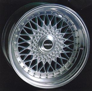

what do you think of these? really similar to the GT diamond spoke wheels. I think a set of these in 16" or 17" would look really sweet on my black wingless 88GT.

Why limit yourself to the stock width? You can go to at least 8.5" wide in the rear, and almost that much in the front.
Those are compomotive CXN's right? Have you been quoted a price for those? Don't set your sights on them until you have. You might be surprised. I think you should do the research to find out how wide you can go before you spend that much money on wheels.

No, haven't gotten my quote back yet.. but I'm sure they aren't cheap.. just thought they would be pretty cool, not something you see everyday on the Fiero. And if saving up some cash to get something I really want, I don't mind doing it.
What brand are those? They look the same as Prime Model 250 - Discontinued now
I have Prime Model 260 wheels, very similar. Pics from link in sig.
http://www.primewheel.com/Primecatalog/pdetail.asp?model=250
