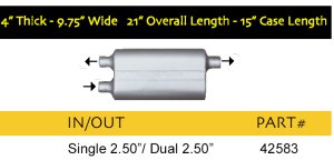

Wait until you purchase the Camaro Flowmaster 80 Series Muffler. It makes it sounds like you have a V-8 under the hood. The 80 Series performance street muffler is specially designed for applications where the muffler must be mounted transversely (crossflow)behind the rear axle, either to match an OE system or for increased ground clearance. The 80 Series is a true crossflow with single or dual inlet/dual outlet configurations and produces a powerful aggressive muscle car sound.
Performance Street
Application Recommendations
Cross-Flow Design
oCrossflow applications.
o1982-2001 Camaro and Firebirds.
Single 2.50"/ Dual 2.50" Part #42583
Look up flowmaster at this address and compare for yourself. http://www.flowmastermufflers.com/web10/productsf5.html
Compare the 80 series, 60 series, and the 40 series. The 80 series is the most powerful and aggressive sounding muffler out of these three designs.
Here is my exhaust system;
Custom made total 2 ½" exhaust system consisting of; very high flow 2 ½" Random Technology cat , Muffler - 2 ½" dual Flowmaster 80 Series - this is the same muffler that the 5.7L Tunnel Port GM motor uses. This exhaust system is much better than the Borla system. 90 db loudness at idle, measured 1 meter away!!!

Hey fierocsp what size is the 80 series flow master?What I mean is, will it fit, no problem or is there a lot of modifications.I heard something like this on a Camaro last week.Muffler with slightly larger exhaust pipes, it sounded awsome nice deep throuty growl, but not over done, V8 best describes it.Thats exactely what Im looking for, the kind of sound that turns more heads than Jason did in friday the 13th.
fierocsp
No longer registered
Report this Post03-30-2003 12:31 PM   Send a Private Message to James Bond 007Direct Link to This Post
Flowmaster: The Camaro 80 Series performance street muffler, produces an aggressive muscle car sound.
4" Thick - 9.75" Wide 21" Overall Length - 15" Case Length
Single 2.50" / Dual 2.50" IN/OUT PART# 42583
Retail Cost = $168.00

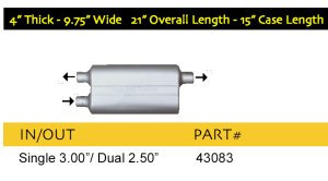

I have a 4.9 being put togethee right now and need to fiqure out the exaust this week. I know that it's going to be Flowmaster. Just not sure which one. I want it to be loud but not annoying, well maybe a little bit! We are going to built a 2.5 or 3 inch the same sytle as stock and need the muffler to fit somehow. Any ideas?

Hey I went to flowmaster.com
found these I'm thinking of using 48083
LMK what you guys think,
Jesse

RacerIT,
The bottom picture is the one I am using. The 3" in and the dual 2 1/2" out is ok in your application. Remember that the bigger the ID the more expensive the exhaust system.
