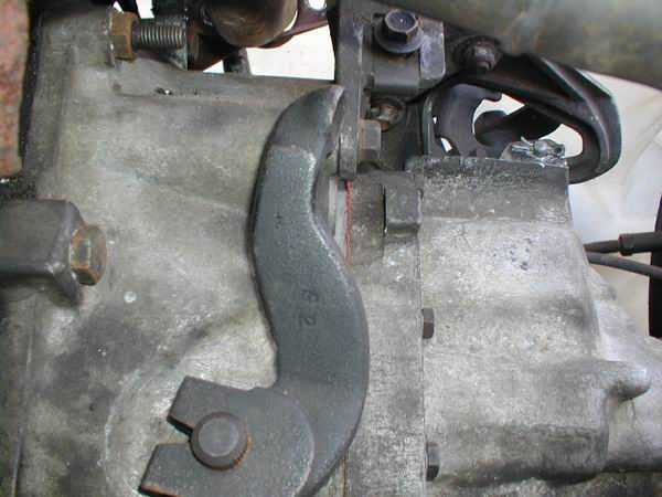

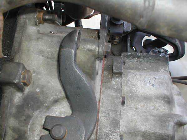

Take a look at the following pictures of the clutch release arm and tell me if this is normal, before I have to pull the tranny off again. How much free play is there supposed to be before the clucth lever arm moves the throw out bearing into contact with the clutch. I have about .9" of free play. I also measured the total travel as 1.75", before I put the engine and tranny together, this only leaves about .85" to disengage the clutch. Is this normal? Help Please, before I start pulling my hair out. I haven't installed the engine yet and this is holding me up. Thanks in advance to anyone that can enlighten me.

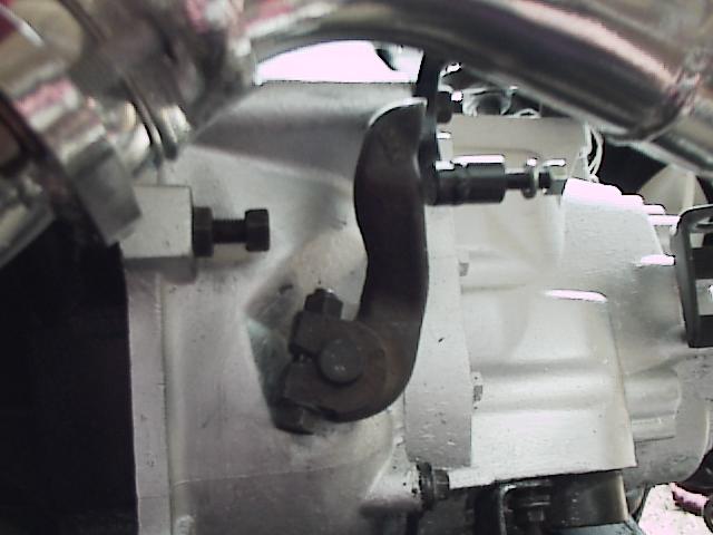

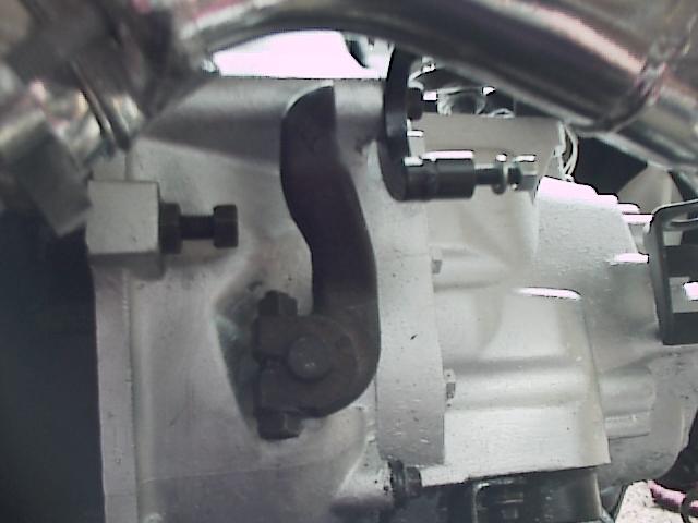

Hey John... This is on a Muncie 4speed, so I don't know if there is a difference. Also, I dont' know the total travel as I am unable to move the clutch arm fully, but here is what I came up with. There is a bunch of free play, and my clutch was fully functional.
Hope it helps any. GL with the install!

Coooooool, Thanks a million John, I can continue with my install tomorrow then.
