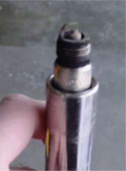

The car does not have a cat. It is an Ocelot exhaust system. Here is a pic of one of the plugs that I pulled. Its green?!? Why??
No I am not loosing any power. The soot does not come flying out all the time, mainly only when I first start it up after sitting for a while.

Well, the only thing I can even come up with for the green tinted deposits is one of two things. First you could possibly have old fuel running through the system if the car has sat for a while. The green caused by varnish buildup. Less likely but still possible if you have anti-freeze entering the fuel system somewhere. Other than either of those, which I'm inclined to think it might not be either I would suggest replacing the plugs to see if the new plugs develope the same green haze.

Well I do know that before I bought the car it ran on a differnt fuel higher than Premium. Not sure what the name is off the top of my head, but the color of the fuel was blue. That might lead to why its this color. I think I am going to buy new plugs and see where that gets me.

I got some blue fuel....it is Sunoco 100 octane unleaded racing gasoline. Sure this guy didn't have a turbo on it, but removed it before selling? How long have you owned it? Just curious......Paul

No it never had a turbo. David Gunsul built the car and I bought it off of him. He is one of my good friends. I have had the car not to long. I bought it just before winter, so really have not driven it that much. I put about 1,000 miles on it since I have owned it. I know that the engine is built very nicley. I think he was going to turbo it, but am not sure. When I get a hold of him I will ask him why the green on the spark plugs. I am sure he will be able to tell me unless someone else here can.
