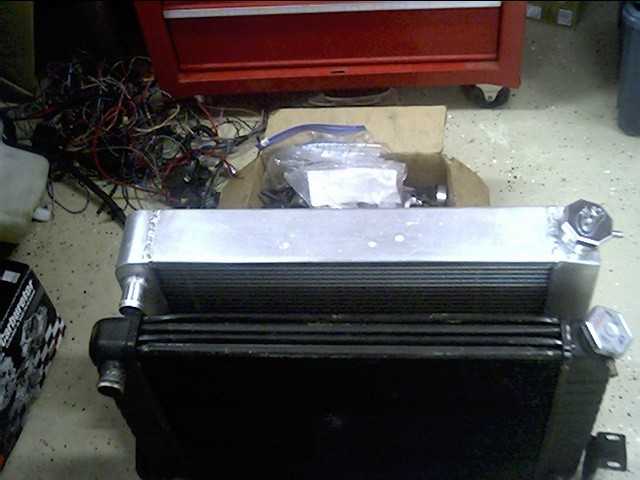

Would someone please post some pix of a four core radiator? How thick is it? I just pulled the radiator in my V8 Archie GT and would like to be sure I have a four core. The one I have measures 2 1/4 inches thick.

That is a shame that radiator doesn't fit ( it looks so nice) what makes it not fit?? It looks like it should if that is a Fiero radiator in front of it.

Why doesnt' the aluminum radiator fit and where'd you get it from?

that alum one looks too tall and too narrow to fit the mounts.

the cap would keep it from fitting in there for one thing.
you'ld have to cut a hole in the hood.

Aside from the cap not fitting, I think the thickness would also be an issue. The radiator is not bolted in like most other radiators, it sits sandwiched between a bottom and top bracket with a hole in the top bracket for the radiator cap. The aluminum radiator looks like a unit made by Ron Davis Radiators (part no. 24163). Ron Davis Radiator sells it for $219 + shipping. The dimensions of this radiator is (24" X 16" X 3"). It has virtually the same dimensions as the Archie 4-core radiator sitting in my car (24.75" X 16.5" X 2.5") except that the width of the radiator is about .5" wider. I'm guessing that anybody using this aluminum radiator would probably have to modify the top bracket to reposition the radiator cap hole and allow for a thicker radiator. By that same token, the bottom bracket may have to be modified to allow for a thicker radiator. Aside from that it looks like a drop-in application. Hose reducers may also be needed.
IMO, $219 is a lot cheaper than what other aluminum mfg want for a custom radiator. AFCO quoted me $425 in 9/01 and then quoted me $479 in 3/02.

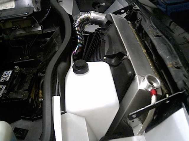

The Held Motorsport radiator is taller than stock and won't clear the hood.
Thanks to Dave Held, we figured out how to install it. I used a 1 inch aluminum block under the radiator holding shroud to lower the radiator and fabricated my own aluminum upper and lower mounting brackets. It's about a 6-8 core equivalent, but it remains to be seen how it works on the street. I installed it with a SPAAL fan and a CSI electric water pump in the back. Looks good anyway!

Nice job, Tom!

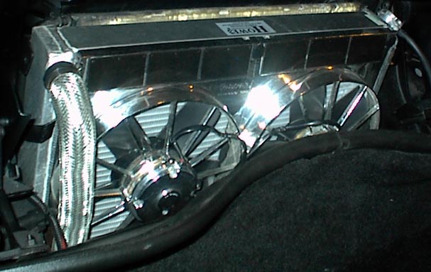

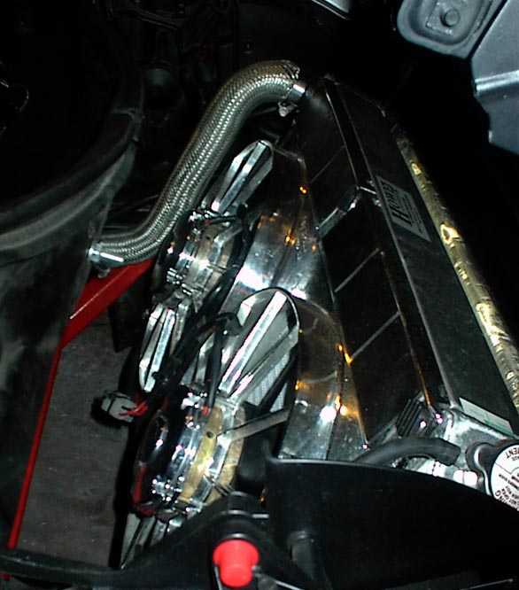

Alright,... I'll bite
Custom 3 core Howe Radiator
Dual Spal Rad fan (slightly modified)
This set-up barely let's my engine (serious ci's) go into the operating temp range.
Tina
[This message has been edited by Tina (edited 05-08-2003).]

THUMP...that sound is my jaw hitting the floor. That is beautiful.

Thank you very much,
I'll forward it to my no good, never happy, only will let you bolt on new parts, doesn't appriciate a thing, primadonna of a Fiero.
No
seriously
Thanks for the compliment.

Tina, looks like you have more money under front hood than most seem to have under the back one, lol. Looks great.

Tina, you're such a show off.
