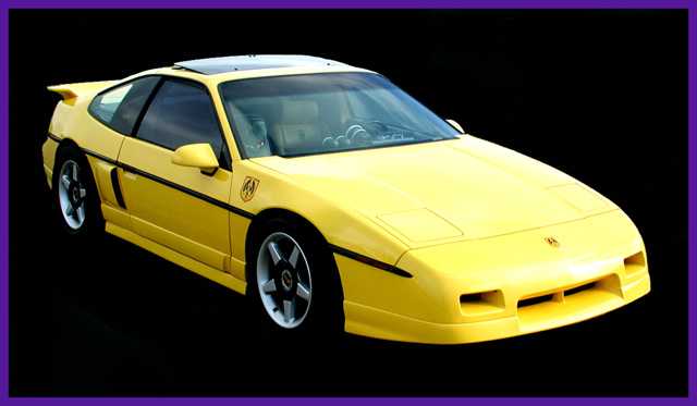

This one was raced on tracks in Southern CA with no cooling problems. Four core radiator you can't tell from stock, 175 thermal fan switch, coolant restrictor flange at inlet to engine (no thermostat), 60% glycol/40% water mix. Handles bumper to bumper stop and go just fine as well.
Click to Listen!
[This message has been edited by California Kid (edited 02-20-2003).]

Very nice looking car, CalKid.

Thanks for the compliment!
Engine is a highly modified 91 Corvette L98, has the short shaft Corvette water pump on it, couple to a Ford single groove pulley (approx 4" dia. don't know PN).
The car was registered in CA (still have plate), but I don't know if the owner had any tricks to registering it there.

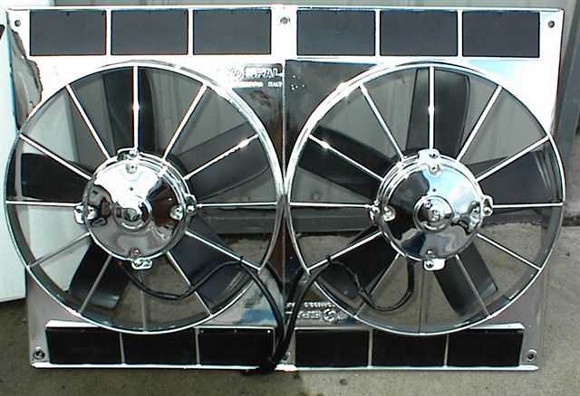

1. Hood scoops
2. Decklid scoop
3. 3 core Alu radiator
4. Electric water pump (moroso?)
5. coolant restrictor flange
6. No thermostat
7. Manual fan switch
8. and the fan of course, well two to be exact
