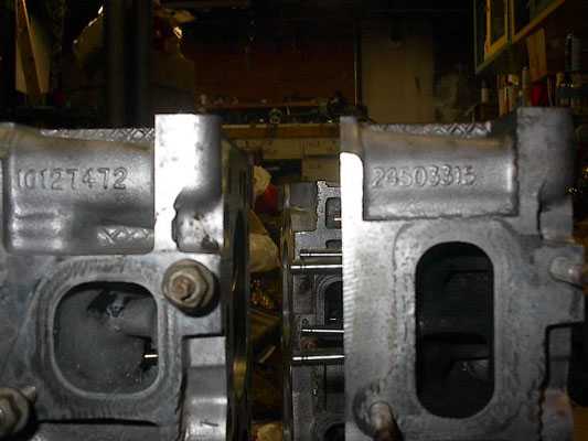

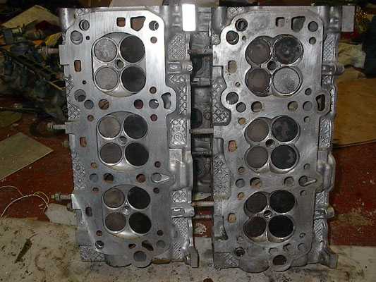

Keep in mind I have 96 heads, Very different from the 91-95's The problem with shaving the piston down to lower compression is that it adversly effects the quench area. The amount of detonation you would loose by lowering the compression would come back when the quench area is lost, the 96 heads have a good amount of quench area when compared to the 91-95 heads. I was thinking of just flat out going with the 3.4 PR forged pistons but only decided against it since the forged 3.4 pistons are specifically designed to raise compression. Stock 3.4 pistons would put me around 8.2-8.5:1 or somewhere about that figure. I will look into what can be done to the forged pistons in order to perhaps lower compression. I'd like to stay away from taking out the quench area if at all possible.
coinball
Posts: 1526
From: Raleigh, NC, USA
Report this Post01-29-2003 10:01 PM Click Here to See the Profile for coinballSend a Private Message to coinballDirect Link to This Post
what exactly is different in the 96+ heads other than the ports, i thought the valves and combustion chambers were all the same? now what exactly is the quench area, i "used" to know what that was i can't think of what it is right now, its been a long day.....anyway, please enlighten me. i keep thinking the quench area has something to do with the compressed air/fuel getting shoved into the center of the combustion chamber, i dunno, anyway, u could get around shaving the pistons by destroking it and going with 6" rods , this lowers the top of the pistons .020" (difference in the rod+stroke length vs stock configuration)....will this affect the quench area also? i'm guessing yes.....

Report this Post01-30-2003 07:06 PM Click Here to See the Profile for FierobsessedSend a Private Message to FierobsessedDirect Link to This Post
It will definatly effect the quench area the same way. Quench area is where the piston nearly touches the heads surface, in the picture you can see the difference in the combustion chamber The (96-97) clover shape has more quench area then the (91-95) non clover chamber.
The exhaust valves on the 96-97 heads are tuliped, meaning they are indented in the center of the valve.

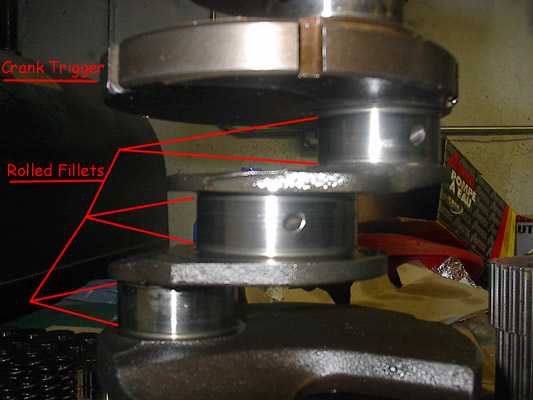

Before you consider using a 2.8 crank in a LQ1, verify that the 2.8 crank has rolled fillets.
Without them the crank may be too weak for such a high powered application, unless you somehow come across a forged crank. The LQ1 crank is also specially balanced for "high RPM balance".

Some of the earlier second generation aluminum headed engines were 2.8's. They also had DIS ignition and therefore have the crank trigger, The external aftermarket crank trigger is a great solution to that problem. But I am still not sure if any 2.8 cranks were available with rolled fillets. Truthfully they arn't 100% necessary, just would be really nice to have for a high performance, REALLY high revving engine.
About changing compression without changing quench area, simple answer: Dished pistons. The second generation engines all had low volume cylender heads and dished pistons, the quench area was good because the flat ring around the top of the piston still came up close to the head maximizing quench area.
Assuming you have flat top pistons that come up level to the top of the combustion chambers, the area highlighted in red show your quench area, as long as the surface of the piston comes close to meeting this part of the head, you have maximized your quench, If your piston stops short of the bore, then none of it almost meets the head, meaning no quench area at all. Now, the area between the red, you can have the piston be dished as far away as you want without effecting quench, providing your piston top is still thick enough. Its the dishing like that, that will change your compression without loosing quench. Take a good look at the web page that 3400Fiero Posted in the top post. He has re worked a special code for his own engine to maximize performance, using a production GM computer. This is by far the cheepest way to do it right. No need for a seventh injector setup. I once installed a turbo on a ZC (DOHC) 86 CRX. We used a computer system that put 2 more injectors into the charge pipe and compensated for the need for additional fuel on boost. Worked pretty good. The injectors were standard style pulse type injectors, varying with boost levels. I don't see any way that you could get a fixed volume injector to work.

Fierobsessed: thx for posting the pics of the cylinder heads!
