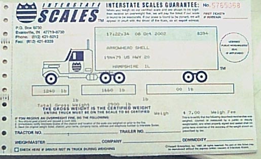

I strongly suggest not relying on truck scales to weigh your vehicle because most are not vary accurate in registering light loads.
LS1swap
Posts: 1181
From: McHenry,IL.USA
Report this Post01-13-2003 08:52 AM Click Here to See the Profile for LS1swapClick Here to visit LS1swap's HomePageSend a Private Message to LS1swapDirect Link to This Post
Thanks for posting the info..... I hope this post stays positive. That last one on weight and swaps went kind of south . I weighed mine at a truck stop probably not as accurate, but it came out to 1240 lb front 1660 lb back with a total of 2900 lb.
That sounds a little heavy to me. The LS1 is definately lighter than my 3800 II engine for sure. However, like I said before, MOST truck scales can't accurately weigh light cars but, that doesn't mean that ALL of them can't. Depends on the company who maintains the unit. I know this because I weighed my Monte Carlo on a truck scale and it said that my car only weighed 3300 lbs. A couple of months later I weighed the same car on race car scales at school and it said the car weighed 3496 lbs. Almost a 200lb difference.
