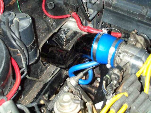

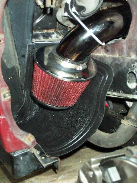

Here's so situational relief: we got Hunt's Christmas present installed. It is a tube/filter designed for a Civic, but fits pretty well. You can see the extra fender well baffel we made to close off the filter box area.
Hunt now wonders if this alternator problem is the Fiero God's wrath for installing something as ricy as this.
