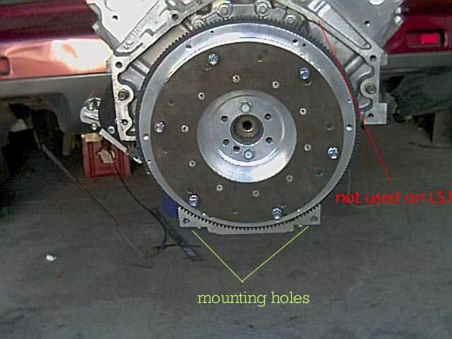

The LS1 had a different bolt pattern than previous SBC engines.
No, it doesn't. It uses a different flywheel/clutch form factor, but the trans bolt pattern is the same.

I honestly don't know that much about an LT5 I do know that it is a 32 valve DOHC engine. Typically these engine have giant heads I think you should get a cross measurement of these if I could. You will notice in the pic I am sending the heads go straight up from the block this leaves room for the exhaust manifolds. the 32 valve engine may not. I am not saying it won't fit ( I don't know) I am just saying this is something I would look into. It will be an impressive swap if you can get it to fit, but I think it will be a tight one. I would bet that it does have to be moved to the left just like the LT1 swaps. The ls1 doesn't by the way. My trans stayed in its stock position. I think the LT1 crowd could help you more than I. Actually as far as technically advanced the lt5 exceeds an LS1. The ls1 has allot of little tweaks over a SBC, but gains most of its advantages over a typical SBC by the angle of the valves, the head design in general, the ability of aluminum to wick away heat, and the ability to custom tune the computer any way you like. but t it is still a single cam pushrod engine. the LT5 is not. It probably shares more in common with a northstar. I hope it can be done it would be one heck of an engine in a Fiero.
You are both kind of right about the bolt pattern the LS1 has every bolt as the typical SBC except one, but it also has an additional two in the pan,. Which is more or less just another part of the block. You can even see a spot for the hole that is missing. The reason they didn't use it is because it lines up exactly with a head bolt

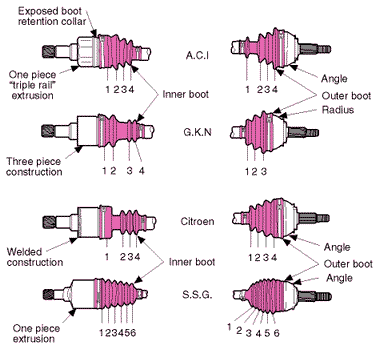

I used the original getrag five speed that was in the car. I did switch from a type 3 CV joint (stock) to a type 1. In hind sight this wasn't an absolute necessity but it did make it easier for me.
What's the difference? What'sa type 2?
LS1swap
Posts: 1181
From: McHenry,IL.USA
Report this Post12-24-2002 08:45 PM Click Here to See the Profile for LS1swapClick Here to visit LS1swap's HomePageSend a Private Message to LS1swapDirect Link to This Post
It has a longer barrel and the end of the splined shaft is flat instead of tapered. There is a flange that sticks out of the LS1 Block. The clamp hits it on a type I but the longer barrel of a type I places the clamp past it. The flat end also allows the clip to be mounted on the end easily, which moves the entire tripot joint out about 1/4" which is just enough to allow a 168 tooth flywheel to clear the tripot. I know not much of this seems to make much sense but it was one of the keys in getting my swap to work. It doesn't matter unless someone wants to use a 168 tooth flywheel.
The top tripot joint in the pic is a type III the bottom one is a type I. I don't know about a type II ????
