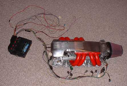

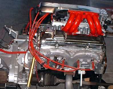

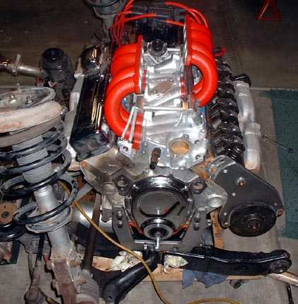

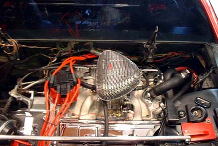

Before
TPI Speed density system from 91 corvette w/ weather proof computer
Beginning installation.
Ready to go in car.
In car
I'll post more as I go.

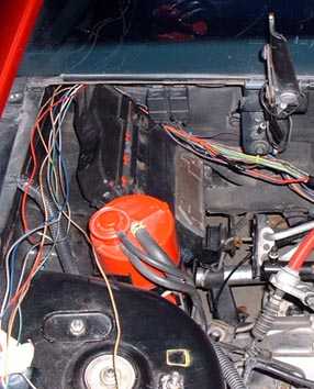

Report this Post12-03-2002 12:10 AM Click Here to See the Profile for sluppy123Send a Private Message to sluppy123Direct Link to This Post
Tight fit

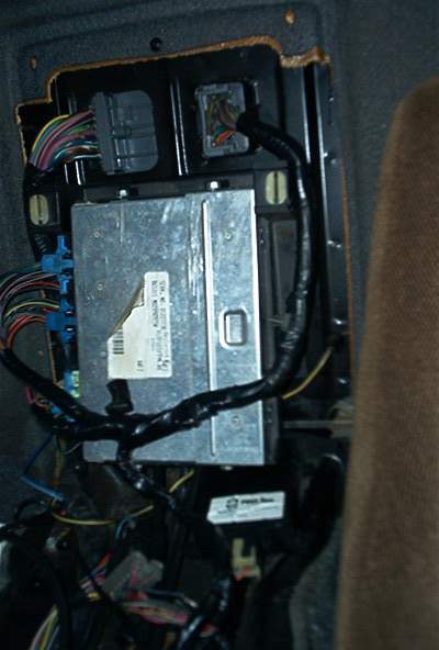

ECM
After fixing a few wiring problems it fired right up. First thought is Its gonna haul some serios a$$. You can really hear the cam, It's the Biggest cam Comp cams makes for TPI engines 260AH-14

Report this Post12-03-2002 02:12 AM Click Here to See the Profile for TCBClick Here to visit TCB's HomePageSend a Private Message to TCBDirect Link to This Post
Could you also post, IN DETAIL, which wire goes where in comparison to the carburator set up? IT's looking real good!

Report this Post12-03-2002 09:48 AM Click Here to See the Profile for LS1swapClick Here to visit LS1swap's HomePageSend a Private Message to LS1swapDirect Link to This Post
Looks nice ... Hate to be second guessing you, but are you sure that is where you want the ECM... I realize it says all weather, but where it is at it could even get ice and snow. I think I would at least put some kind of cover over it .....I put mine in the corner of the trunk it tucked away pretty good and doesn't take up much space. Not knocking it ....It Looks very nice you will be pleased when it is done

Report this Post12-03-2002 01:11 PM Click Here to See the Profile for jelly2m8Send a Private Message to jelly2m8Direct Link to This Post
Anyone using a stock TPI ECM, it will bolt right up in the original Fiero ECM location using a 88 2.5 ECM bracket.

Report this Post12-04-2002 01:25 AM Click Here to See the Profile for sluppy123Send a Private Message to sluppy123Direct Link to This Post
Answers To a few questions.

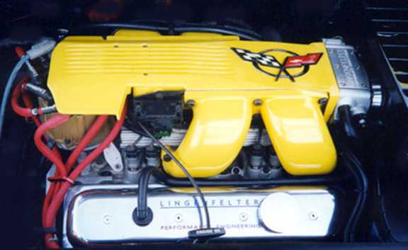

I do plan on covering the ECM to keep junk off of it, it's the Stock weather proof ecm from 90-91 vettes. My TPI system Came off a 91 vette, and it does have a EGR valve. The vette Alum heads didn't have heat risers in them, so a tube connected one of the headers to the intake. I made some alum block-off plates as I'm not using the EGR system, I had it removed along with the VATS from the Prom. The plate in the center of the picture is covering the EGR inlet

Looks familiar!!! You're going to have fun!

Wow they both look nice I think that is the first time I have seen a pic of California kid's engine. Good idea to get rid of the EGR I did that as well. Eventually I want to get the LS6 intake with no EGR. Once again looks very nice

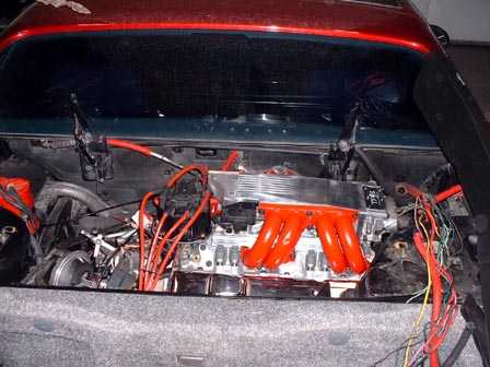

Looks great. I love the look of the TPI. Here was mine, albiet in my Firebird:
My other reasomn to jump into this post, other than praising your work, is to ask why don't more people use the LT1 intake. It seems like such a better fit to a SB Fiero with it's high winding ability versus the TPI's low end torque.
Just curious...
BTW, this is why I mentioned it (and agin in my Firebird):

RCR
Posts: 4416
From: Shelby Twp Mi
Total ratings: 102
Report this Post12-05-2002 08:06 AM Click Here to See the Profile for RCRSend a Private Message to RCRDirect Link to This Post
When I had the TPI, I had an LT4-hot cam, ported intake and siamesed SLP runners (not in pic), 48mm TB, TFS TW g1 heads, and 1 5/8" TES headers. It maxed out at 5400RPM. A larger TB and 1 3/4" headers would have helped, but the RPM peak would not have moved much. These are typical results from the thirdgen f-body groups. With just the LT1 addition, I can easily hit my rev limiter at 6200RPM, still spinning the tires as before. Results at thirdgen.org show approximately 30-40hp gain over the TPI. Check out www.LT1intake.com for more info. BTW, John Millican is a good guy, but I'm not associated with him in any way. So I'm not trying to sell his product. I did mine myself.
