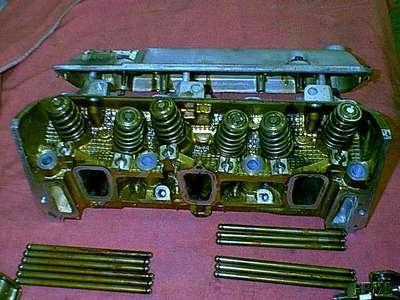

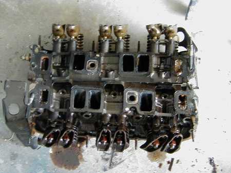

The Gen III aluminum heads flow 37% more air than the cast iron heads. The design in the aluminum head for the combustion chamber is different than iron heads. You cannot just take the iron heads off and put aluminum heads on without changing the pistons. The C/R will be way to high.
The lower intake is not interchangable between iron and aluminum. But with more air flow in aluminum heads the lower intake off iron heads like the 2.8 lower intake is to restrictive. It will not let enough air flow to get the full potential usage.
As far as over heating, aluminum or iron if you run out of coolant your in trouble either way more than likely.
Heres a coupl of pics intake side of the heads.
Aluminum GEN III
Cast Iron Heads
