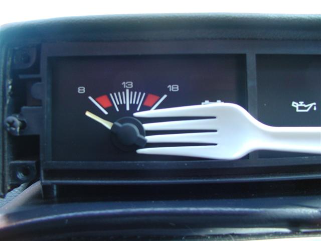

Hmm, sad to say it didn't work as well as I planned. I tried it on the aux gauge needles. They pulled off fairly easy with a plastic fork wedged between them.
The OEM paint was some kind of sticker or paint material that refused to come off. I tried both WD-40 (from a previous forum suggestion) as well as "Goo-Gone". One of these two products severely clouded the plastic. Once I got the paint removed and scraped off with a razor, I painted them with the above paint and it went on fairly smooth. The two black "caps" on the needles come off too but a stem that the needle snaps onto with these black caps busted off so out came the superglue. All in all I was disappointed because once I got them installed, the paint was too dark and didn't have the same flourescent glow that I was looking for. Just wasn't worth effort.
It sure is wierd to think the gauges should be orange considering all the ones I have seen appear to be a bright yellow. Ohh well, maybe I'll send em in to a professional company and get them redone.

FWIW, the indicator on our auto trans console was faded almost to a non-existent color. I took it out and used an Orange Sharpie marker and just colored in the back side. I've never seen a new one, but it looks good to me.
