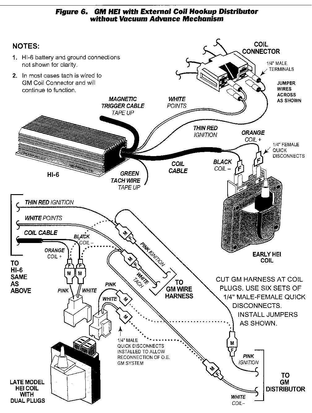

Report this Post02-22-2003 06:29 PM Click Here to See the Profile for avengador1Send a Private Message to avengador1Direct Link to This Post
Here's the wiring for one from Crane, The MSD is probably similar.
[This message has been edited by avengador1 (edited 02-22-2003).]
