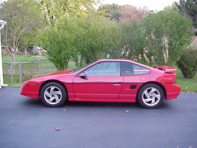

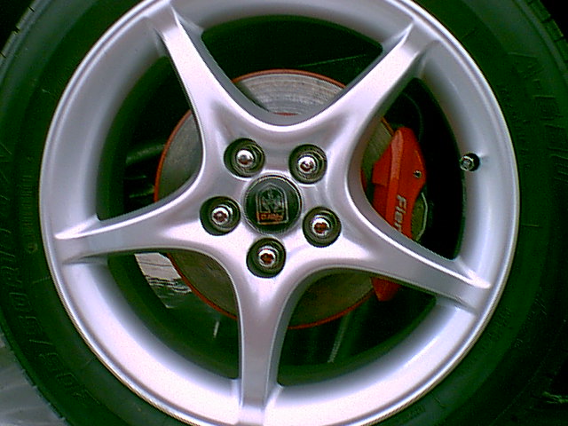

Not a GM wheel but, I have 16's from a Toyota Celica GT on my 88

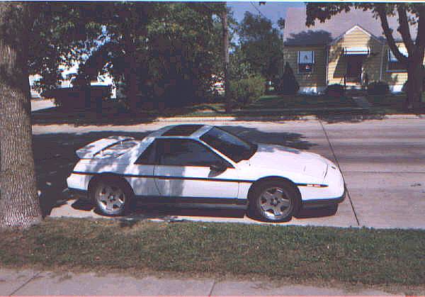

here is a pic of 91 GTZ wheels

88coupe.....what year and type of celica did those rims come off of?

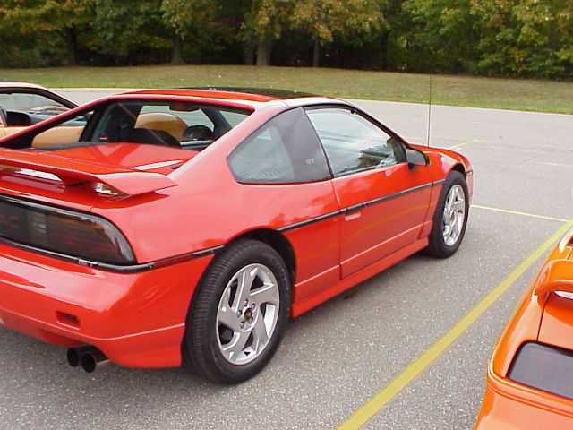

These are from a 2003 Pontiac VIBE. They are actually Toyota wheels (VIBE is a re-badged Toyata) and require some machining work to fit the GM hub. The center hole needs to be bored out from 54.1mm to 57.1 mm. I had a local machine shop do the work. The only reason I gave these wheels a try was that I got a heck of a deal on them at a local Belle-Tire who had swapped wheels on several Vibe's from a local dealership.

bump...still curious about the celica rims.
I had a set of these on my 86GT and they looked WONDERFUL! If you use them directly off of a Toyota you will have to machine them slightly or it can be done with a dremel tool quite easily......to the center so that it will fit. It's just a few mm's too small, but will work great!

What year Toyota....those look killer.
Sweet wheels turbotoad. You gotlucky.. There aren't many Vibe wheels in the boneyards yet and I'll bet Pontiac wants at least 500.00 a piece for those at their dealerships.
Very nice..

WOW, I have a VIBE GT and i was woundering what it would look like with the wheels on, i new that they didn't fit without some machining so i never tryed it. ONce you cut them, they will not go back on the Vibe so i have not done it. Thanks for the look. I may do it now. BTW. I also have the beretta GTZ wheels on my car now
