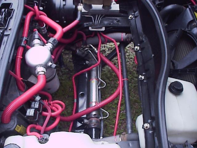

I've never done this conversion but I'm not afraid to modify stuff to work. The steering shaft looks like all it requires if to cut it off and grind a flat side to mimick the Fiero rack. Since the housing on the Merkur stick out futher than the Fiero rack, the intermeadiant shaft may eed to be shortened to compensate. I've never check the intermeadient shaft but it may be collapsable (a safety feature in cas of an accident) which would make shortening it easy. If not, you may have to have to cut it and reweld to the correct length (actually, I just re-read Kasden's note and he mentioned shortening this interm shaft).

Contact the Zimmer motor car company. I think its http://zimmer.com or somthing like that. They used the Merkur P?S rack on the Quicksilver, you know the pimp daddy species of the fiero world. They did it to the 1985 and 1986 Fiero. They might even have the drawings for the specific assemblies and what parts were used. You may have to find another pump to use with the LT-1, Froem what I've seen, its pretty tight in that area. S.WIlliams 1987 Fiero SE (Northstar V8) autopsy completed, cause of death was a hole in the block caused by a failing pushrod...

I wanted power steering because I will be using 285-35-18's tires all around. I am building a 355 spyder replica so I do have an extra 3" for the power steering pump on the LT1. I don't know if it will be enough because I haven't test fitted the engine yet.
Thanks for the pictures Howard, hopefully as a result of this thread we will have a step by step procedure for installing power steering on a Fiero.
