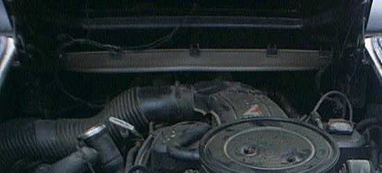

i attatched a piece of aluminum angle to what i guess is the lip the rear window sat on. i found weatherstrip at autozone that sits well on it' the side covers fit right up against it. if i can find the strip that went on the lid it will be pretty well sealed.
got this scoop today (should have got a pair. need to contact seller about where the other is). i hope to use these with some '84 side covers to have the engine air exit a little further away from the passenger comp. i may try it with out the fans and add them if needed.
i have since driven the car on a cooler day and it was better. i hope this will make it more enjoyable still.

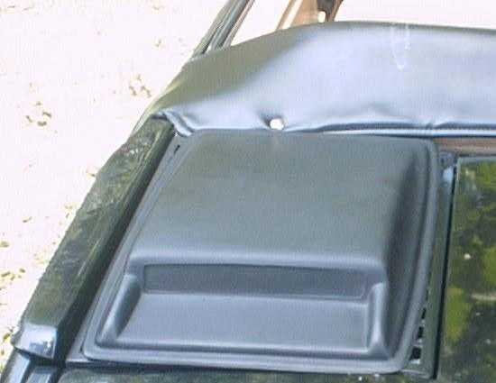

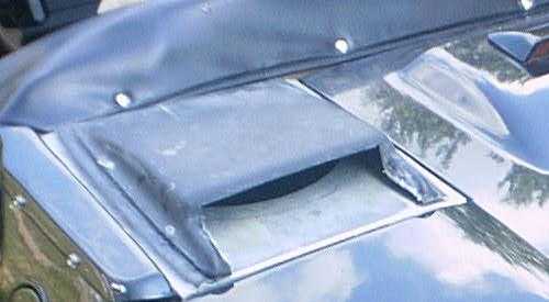

got the fans...

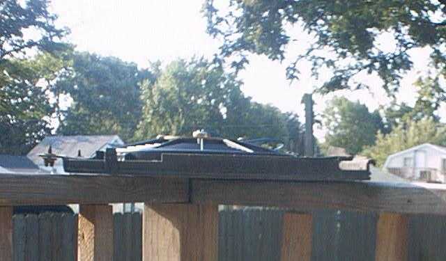

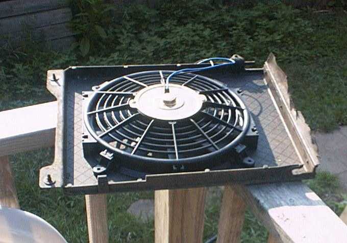

found them on ebay like the scoops. i was kind of worried about the thickness of them but since i'm going to use some '84 engine side covers they sit in pretty well...
i'm sure it will clear the battery and i believe the vapor canister on the other side. got started on some other projects so it might take a bit to get back to this.
Philphine
Posts: 6136
From: louisville,ky. usa
Registered: Feb 2000
Total ratings: 54
Report this Post08-22-2002 12:31 PM Click Here to See the Profile for PhilphineSend a Private Message to PhilphineDirect Link to This Post

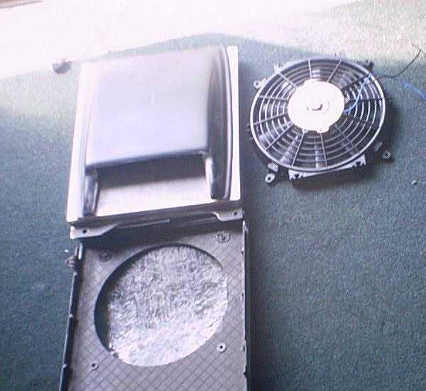

the covers cut out, with mounting nuts attatched, and the vent set in place with two sided tape. i'll be glassing the scoops on to try and give it all a one piece look, plus i'm not sure if the tape can take the heat by it's self.

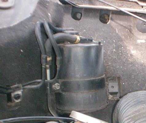

on the battery side, there was no problem with clearance. on the driver side i had to lower the vapor canister. just had to take off the bracket, which is held to the indide fender with two screws. i cut the insulation under the original mounting spot, and then i was able to align the upper bracket hole with the lower fender hole.
at this point it's just a matter of trying to do good glassing and deciding how to wire the fans. whenever i get it done i'll post on weather it helped with comfort or not.

i think it's working. it's not like a crisp fall day. guess it never will be. but it's nowhere near as oppressive. right now the fans aren't in but may not be nesessary. i wanted them because i knew i was blocking the normal airflow some with the vents but my temp guage read the same as before in traffic and on the x-way all day. going to put them in anyway since they are part of the plan. they might still help on a really hot day.
the last thing i need to do (besides cosmetics on the scoops) is find the recall trunk lid strip or something like it. the last of the unblocked hot air is coming from there and if i can close it off some it should make for a much more enjoyable ride.

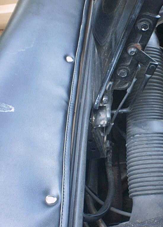

i was just looking for the thread to add this. had to get creative. this is the stuff that goes at the bottom of a house door. stuck it in the old clips that were still attatched. again, no real difference on the temp guage (a little higher when i got into some slow traffic) but still not enough to kick the fan on.
not quite as hot as that first day, about 90deg. or so but i can still tell the difference. i can still feel some heat at times but it's not that constant hot breeze like at first. the only reason i'm back posting this is because it clouded over and there a high enough rain chance percentage that i didn't want to gamble. i could drive it all day.
i think when i wire the fans i will have them work with the radiator fan. they don't really seem to be needed so if it gets hot enough to kick on the front fan (so far just once in very slow traffic) they can help then. that should also cut down on the noise of them running right behind me. i test ran one and have the feeling two going right behind me would get pretty annoying.
ok so thats it. there may be another thing or two i try but i feel like i've been successful. and the sun just popped back out so i may need to run some more tests. see ya.
