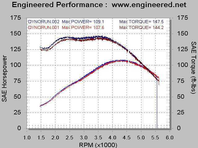

Kosei K1s are a lighter wheel ( www.tirerack.com ). along with a 70,000 mile tire (420+ treadwear) and slightly elevated tire pressures would yeild better MPG.. less rotating mass and less tire deflection what kind of weight reductions have you done? the stock camber but pull some of the toe out of it.. find a good reputable alignment shop and speak with thier technitian while your cars on the rack. do you use your a/c? that belts wasting MPG if the a/c's not functioning.
edit---
what oil are you using? Synthetic usually helps. (helps on the dyno i'm sure it'd help for MPG too.) i'm with them on the K&N too. it flows better at any RPM range...
https://www.fiero.nl/uploads/BlackGTdyno.jpg - dyno results help a little the entire rpm range.
