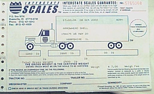

I was wondering if others who have done engine swaps have had their car weighed.
I took mine to the scale just a little while ago. The car is an 87 five speed GT with T-tops and 5.7 LS1 conversion. I topped it off with gas just before putting it on the scales.
It weighed 1240 Lb. Front axle 1660 rear axle and 2900 total. That comes to 42.7% front 57.2% back. What is the weight of a stock GT with t-tops, and if others know the weight of other swaps I would be interested in knowing.
LS1 in and running :)

Hmmm the figures baffle me. I believe one of us must have gone to inaccurate scale. I doesn't make sense that a cast iron zz 350 would weigh 20 lb. Less than the LS1. I was told that an LS1 Is 90 lb. lighter than an LT1 don't get me wrong I am sure those are the numbers the scale operator gave you... I just don't see how they both can be correct.

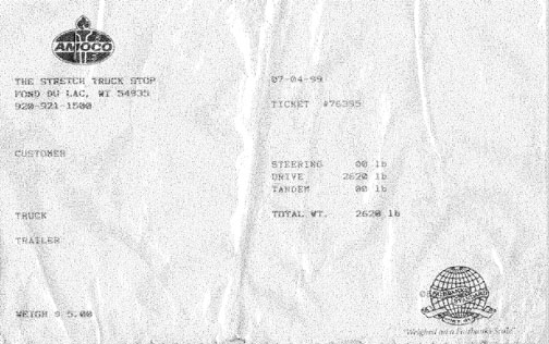

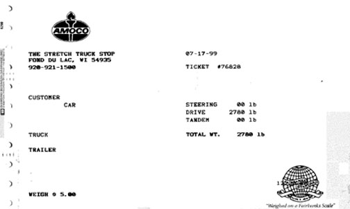

I posted this info before but people were too busy telling me how inaccurate Scales were to pay attention.
We removed the stock 4 cyl. Engine and replaced it with a 400+ HP 350 engine with cast iron heads and Alum. Intake manifold.
Both times the car was weighed it had half tank of gas and all other conditions were the same.
The "Before" weight was measured 07-04-99 and the car weighed 2620 lb.
The "After" weight was measured 07-17-99 and the car weighed 2780 lb.
The net gain for the V-8 swap was 160 lbs. Total from 4 cyl to 8 cyl.

Did you see the weight slipss I posted above?
