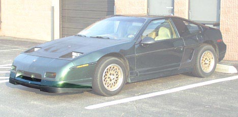

I Guess I can help
I figured this would be one of the best ways to show what part of the original nose was used when someone else asked (the dark area is what is left to make the air dam):
Baiscally, I started out by cutting along the existing "trim" line separating the nose. I then used masking tape to mark the correct angle on both sides- then trimmed. Next, I cut the inside edge of the nose to about 2-3" all the way around (easier to work with then).
I used a RotoZip trimmer for all the cutting- then started with 80 grit sandpaper to get the edges all smoothed evenly. I have finished some sanding with 160 grit, but have not gone farther with the airdam as I have a bit more "tweaking" I'd like to do.
I attached mine (a 2nd or even 3rd pair of hands would've been helpful at this point) with srews (I used sheet metal screws with "finish" washers) spaced about 6-8 inches apart all the way around.
I do plan on going back and adding a few areas of additional support (my initial attempt at supports was greatly flawed and I ended up just completely removing them).
Any more questions... just ask and I'll see if I can make sense of it for you! (I asked Ski a ton of questions before I made any cuts at all).

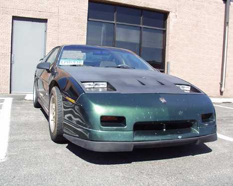

Gee, I don't know how I missed this thread. Never throw out GT noses. I also used a messed up rear bumper to create the light pockets. The light pockets were rear reflector pockets from a GT rear bumper. The black air dam is still in place and very fuctional.

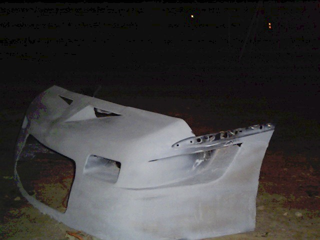

Report this Post10-01-2002 05:37 PM Click Here to See the Profile for EarlSend a Private Message to EarlDirect Link to This Post
And hear is the first fitup of my spoiler.
Earl
Posts: 945
From: Dayton Ohio USA
Report this Post10-01-2002 05:39 PM Click Here to See the Profile for EarlSend a Private Message to EarlDirect Link to This Post
Earl
945 posts
Member since Oct 2001
Ok Ill try again
Earl
Posts: 945
Report this Post10-01-2002 05:40 PM Click Here to See the Profile for EarlSend a Private Message to EarlDirect Link to This Post
Earl
945 posts
and

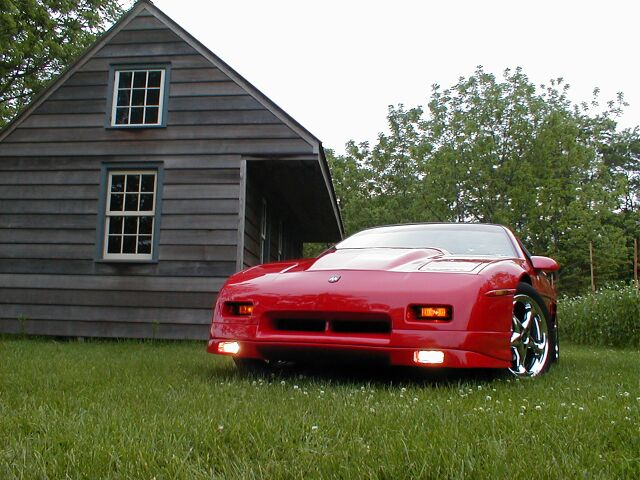

If you look at my sig, you can see how it look's "SMOOTHED"! I did this same thing except, I glassed mine ine to eliminate the seam!, My puter crashed, So I lost bigger pic's of my front fascia. Anyone have any of my fascia??
