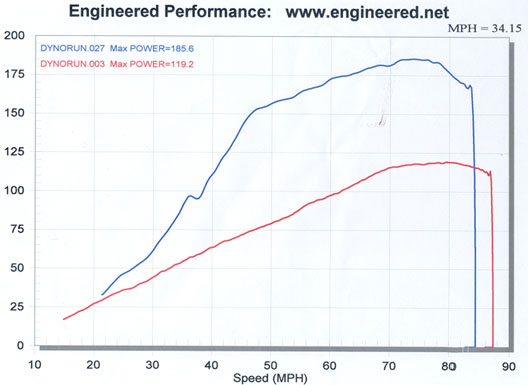

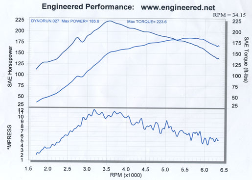

well this is what i have.. but was informed after i left the boost pressure problems were aleviated and she makes 226hp and 241lbft at the ground..
see how the turbo wasn't holding boost.. it'd spike at 11psi and die off.. well NOW with the -CORRECT- vacuum actuator it'll hold 10-12psi from 3200 to 6200rpm
what a deal... $4000 for intercooled with engine management and a hell-of-a-good-time!
the engine this was put one.. a 95 Grand am Q4, 5spd, 136,000 miles. -white, on grey.. hehe.. if you wew wondering... oh yeah and white 18s
