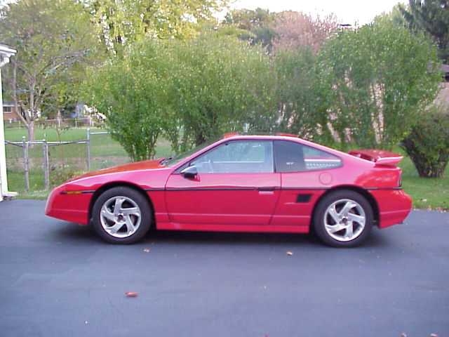

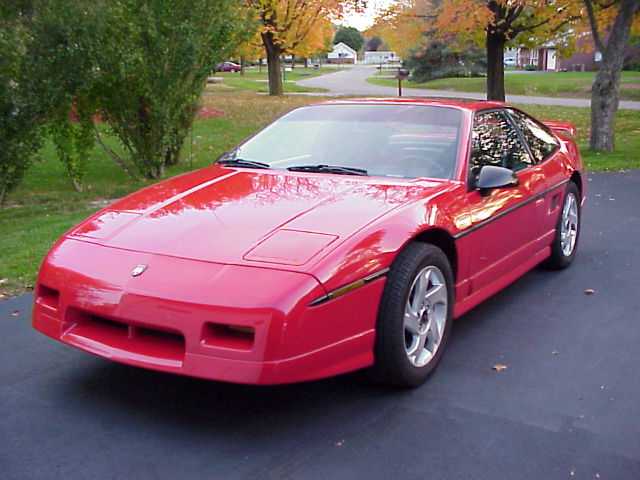

Well, it took a few weeks but I finally got the VIBE wheels machined at a local machine shop (bored out the center hole) and put them on the car. They look pretty darn good on there!
After measuring the new wheels and comparing them to the original I have determined that the outside face of the front wheel has moved outward 5/16" and the rear has moved inboard 1/2". The tires on both the front and rear are currently 205/55/16 and this makes the rear look too tucked-in compared to the front and also makes the back-end look too squatty.
I'm going to buy some wider tires for the back tomorrow but I'm having a hard time figuring out the right size. The original tires (205/60/15 & 215/60/15) resulted in the front tire being 1/2" smaller in diameter than the rear. Keeping this relationship is my goal.
I want to go as wide as possible but the wheels are only 6.5" wide. So, I think the widest I can go on that size rim is 225.
A 225/50/16 is listed as having the same overall diameter as a 205/55/16. A 225/55/16 is listed as being 3/4" bigger in diameter than a 205/55/16. So, to keep the "original" front to rear size relationship similar the 225/55/16 makes the most sense. But this is 3/4" bigger than the original 215/60/15 and would really fill the wheel-well up.
Anyway, take a look at the photo's and let me know what you think.

They look very nice

Car looks absolutely fine, but then I'm a sucker for anything in red. Hey, we ought to get together for a beer sometime, swap lies about Fieros etc. I'm in Grand Blanc and thats what??? maybe 10 minutes from you?
Nice job on the wheels, good idea. Oh btw I've got a silver 86 1/2GT
