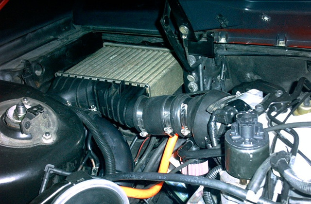

Picture of an intercooler installed in a turbo 3100. It is a saab 900 intercooler. The side intake feeds air to the underside, a fan beneath it blows air through and it vents out the top of the drivers side engine vent.
85 F-40 Replica (unfinished)
88 GT 5-speed
02 Millennium Yellow C5
[This message has been edited by godalex (edited 10-06-2002).]

What you don't see in the pic is the fan and ducting under the intercooler. The fan (small radiator fan)runs all the time when the engine is running so it is pulling cold air from the side air intake and forcing it through and out the vent. I doubt that very much engine heat enters into the equation, but then it is not my car and I don't know. (If it were I would isolate it though so heat wouldnt be a problem) I think the idea is practical and brilliant, a great balance of all the variables, access to a place to vent air, location close to an air source, proximity to the intake. I posted it only because I though it could be of use to someone.
The thing I don't like about water injection or alcohol injection: If others drive the vehicle. In that case, the other person may not refill the reservoir, and could blow the motor.
In my experience idiot proof is always good, and an intercooler doesn't require the regular service. One of the main rules of engineering is to perceive potential problems and address them ahead of time.
Food for thought.
