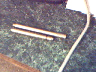

here is a picture of what i'm going to try in place of the original slave push rod

the longer rod pushed the pisten in the slave all the way to the back of the cylinder. the longer rod is exactly 15/16 of an inch longer then the original one. i guess i'll shorten it a half inch and try it.

well shortening the rod a little didn't do anything.
