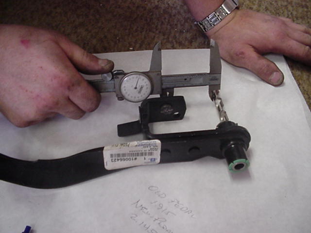

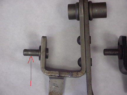

This is an unbent Steel pedal....

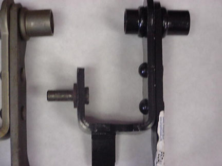

This is a Alum. pedal......
See how the Alum. pedal has the "U" shaped bracket bent upwards?

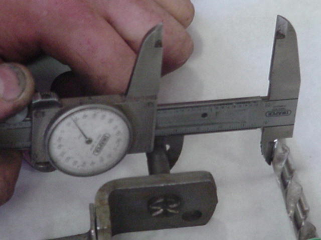

As you observe how the "U" bracket is bent upward, do you also see how that bending moves the pin closer to the pivot point of the pedal?
When that pin moves closer to the pedal pivot point it shortens the distance that pin travels when the pedal is pushed down.
Here is a comparison of the pedals .......
I've been doing V-8 swaps to the Fiero for the last 16 years. For the first 2 years I struggled ALOT with clutch problems that I now know were because of the bent pedal. About 14 years ago we found the bent pedal problem on one of my cars. I've seen some Aluminum pedals that were worse than the above pictures and I've seen some that were better, but I cannot remember seeing one that had no bend at all. Now, for the last 14 years, I've been advocating replacement of ALL Aluminum pedals.
Now your going to tell me that you're Aluminum pedal isn't bent and your not gonna replace it. I'm here to tell you that you are asking for trouble....I've seen these pedals going from being ok & driveable to UNDRIVEABLE overnight.
I'll tell you the story about me getting stranded in Upland, CA 14years ago when the pedal that was just fine yesterday wouldn't let me shift into any gear this morning.

Archie,
Thanks for the photos & info. I have heard about this problem for a long time but never seen exactly where the bending occurs. By the way, I would also assume that the aluminum pedal must flex each time it is depressed in order for it to take a set, so the measurement could be much worse when you are actually shifting.

You're right, when the pedal is depressed the "U" bracket distorts even farther from the pressure of pushing in the Master Cylinder. All of this distortion directly affects the total travel of the Slave cylinder. You need as much travel of the slave cylinder as possible to properly operate the Fiero Clutch and all this deflection and bending shortens the salve cylinder travel.
