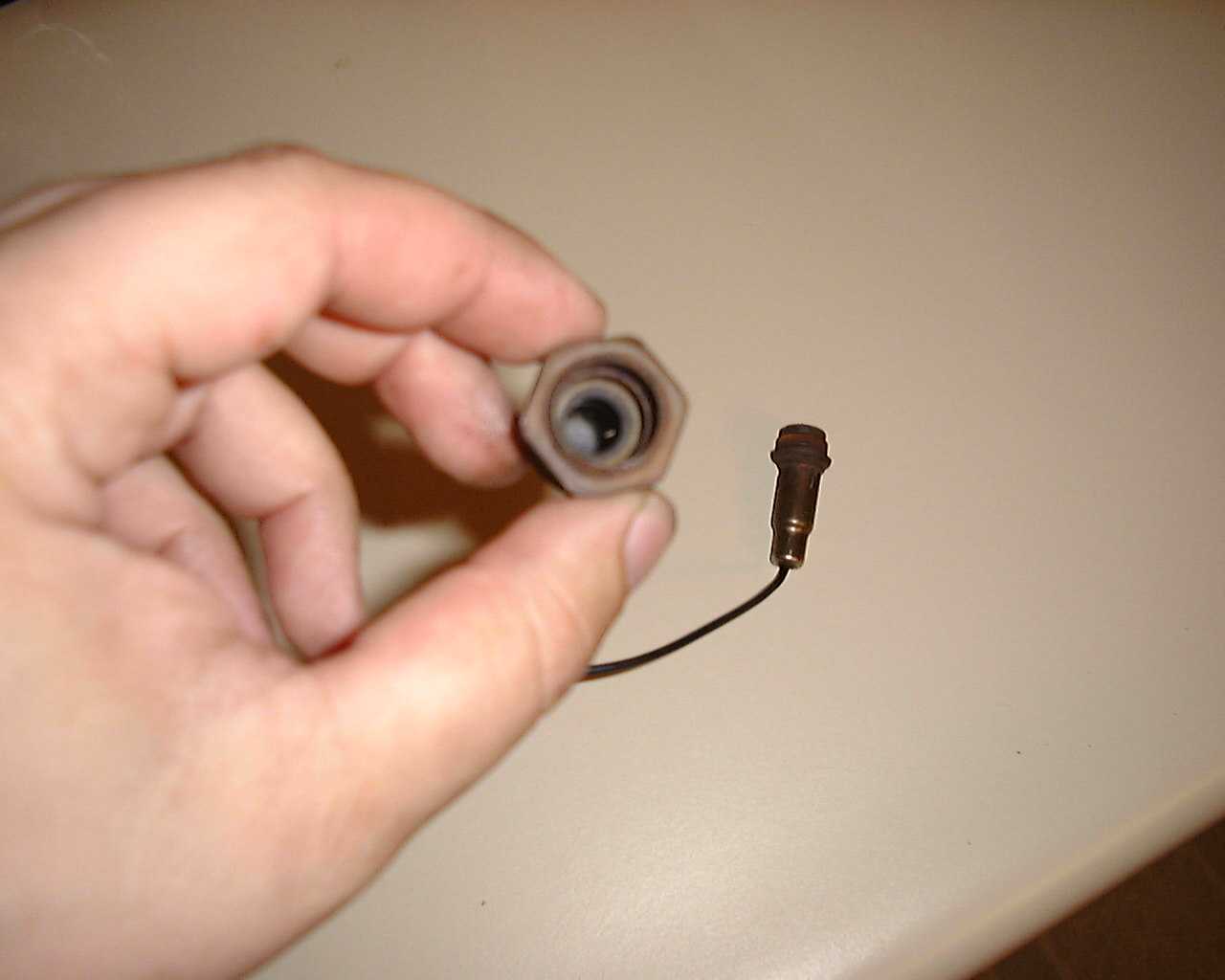

That's a whole other story... That light is gone along with a few others. Maybe had something to do with the O2 sensor being gone! I'll have to post this pic when I get home but there was just the screw in part, no ceramic or anything left. I found the wire dangling with a few other parts not connected. I suppose the thing drove because it was in limp home mode.

Report this Post08-20-2002 08:09 PM Click Here to See the Profile for Fiero_FreakSend a Private Message to Fiero_FreakDirect Link to This Post
Fiero_Freak
1125 posts
Member since Oct 2000
Well here was the deal... at least part of it. Funny thing is now the gas milage is suffering. What do you think? Possibly a clogged cat?

ok first things 1st. replace the o2 sensor. check for codes usually you will get 2 or 3 of them. then disconnect the neg terminal on the batt to clear the codes then hook it all back up and run the engine to see if you get another engine light. if you have a stock cat I would replace it for the heck of it. let me know...

Yeah.. I already did all of that minus the cat. I've since hooked it up to the computer and have gotten rid of all the codes. I thought of the cat because of the gas milage thing. Doesn't the computer make the car run rich in an emergency state like that? I thought that probably fried the cat. I was going to pull it temporarily until I can get a replacement hi-flow from Summit or something.
