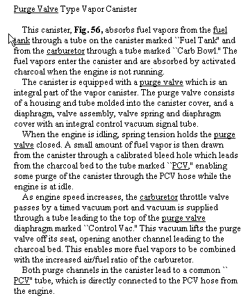

I tested my canister a few minutes ago....
They all appear connected backward to what the lines are marked on the canister. (The canister labels are correct....) I also checked a V6 VECI and that one looks "backward" to.
Either way, the canister will only purge off idle but it will purge slower the the way it comes factory. The ported vacuum signal typically draws only 7-10 inches vacuum compaired to manifold vac which is around 20 inches most of the time.
It's hard to say if we should "correct" this problem or not. (I'm going to keep messing with it over the next week and see what if any dif it makes.)
Tested operation... The PCV port only opens when vacuum is applied to the Control Vac port.
This image is the descriptoin of the valve operation. The only dif is our canisters don't have the carb vent. (It's a screen grab from an Alldata PC)
Just why millions of these things are connected "backward" is hard to say.
Either GM did it on purpose. I'm not sure just what they thought it would accomplish.
OR
They screwed them up and didn't want to bother fixing it. Since the cars will still pass emmissions testing, Why spend money to fix a problem you can hide for free?
Service testing doesn't change... If you are checking for the purge valve leaking, plug the two lines and see if the problem clears up. Best to plug them on the engine if posible, which will also elimnate any rust holes in the metal lines.

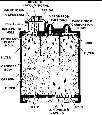

32520 posts
Member since Mar 99
Here's the diagram that goes with the above discription. It shows the valve open to purge the can.
