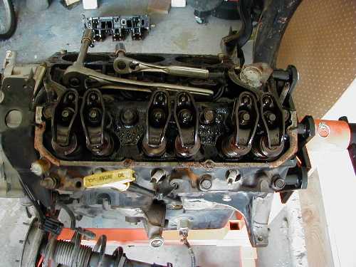

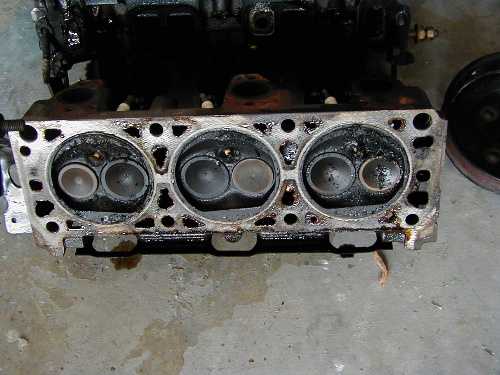

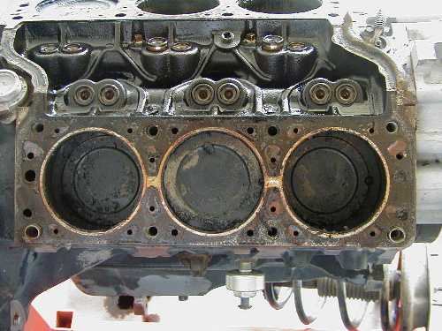

I picked up the 3.4 today and started the tear down. It has alot of carbon buildup inside.
Any ideas you guys have to gets more Horse Power out of this thing lets hear them.

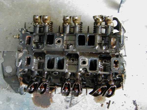

How's about a picture of the intake ports on the heads? I would like to see if they look like the stock 2.8 heads.

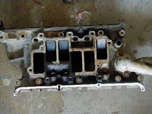

To me it looked like the Stock plenum would match very close. Without actually sitting one on its hard to tell.

Here's some pictures of my new engine. Sorry to highjack your thread. You can see some of the modifications done to mine in these pictures. These could help yours also. I had the heads pocket ported, I also have full roller rockers now. The engine was bored and stroked to 3.4 from 2.8 and Im using a Crane Compucam 2030. Im interested in a picture of the heads intake side, like my second picture, Thank you. and

Yes the 3.4 heads match up to the 2.8l intake. They are the same heads.

Heres a pic on intake side of the heads. Don't worry about highjacking the thread. The more info here on 3.4's the better.
I hoping to get around 215-230 normal aspiration.

Hey Earl.... I'm going to see if I still have that 3.4 intake. I don't think that I kept it...but I'll keep an eye open for it. Reversing that one may be a possiblity.
