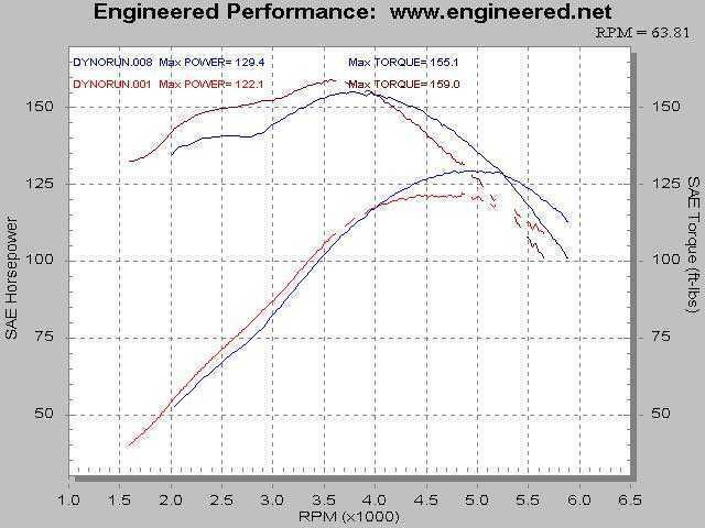

Removing or gutting the cat on a stock 2.8L will cause you to lose low end torque. Unless you have a modded V-6, the low end torque loss will be very noticable.

As the burnt gasses leave the cylinder, The back-pressure allows some burnt gasses to remain in the cylinder. I am not sure of the exact scientific reason that this is a good thing, but it has to do with the burn rate of the next compression cycle. If you increase intake flow then the exhaust flow can be less restrictive. In Dennis' case he is using a turbo so the compressed A/F mixture creates more power.
When Travis tested the cat/no cat issue, I think there was a 4 lbs of torque lost at the low and 3hp gain at the upper RPM range. With the loss of torque at the low end your launch is less.

Correct. At lower engine speeds, some backpressure helps with scavanging and helps to up the torque. As engine speed increases, the dynamic changes and the backpressure becomes a restriction to flow volume.
Lower backpressure causes a loss of low end torque with a potential gain of upper rpm horsepower. The actual gain has to do with wether your engine can make use of the added flow at hi rpms. If it can't, you just loose torque with no gain.
This is why Ferrari used a 2-stage muffler system on the F355. The low-speed side was quieter and had more back pressure to help low rpm torque, but under heavy throttle and hi rpms, it switched to a hi-flow side for better top end horsepower. Ferrari doesn't do things for the gimmick.

Man I don’t know where everyone keeps getting the idea that back pressure is good; its one of the most mis-understood misconceptions ever. No back pressure is ever good for any engine period. The reason why the low-end torque is reduced is because the increased flow reduces exhaust gas velocity at low rpm thereby reducing the amount of air the engine takes in. The exhaust system is a compromise and its diameter effects exhaust gas velocity.
The reduced exhaust gas velocity at the lower rpm means the engine takes in less air thereby making less power. Did you ever wonder why equal length long tube headers increase low-end torque significantly? They certainly don’t “increase back pressure”. They increase exhaust gas velocity at a specific rpm and help scavenge out spent exhaust gases thereby making more room for a fresh air and gas to come in. Short length headers do the same thing only at higher rpm.
[This message has been edited by 88formula (edited 08-10-2002).]

lose torque.. yep.. its VERY noticable as a daily driver... or light to light toy.. but if you keep the car tached up above 4200 all the time you'll be happy.
ditching the cat i lost even more torque.. yeah you'll gain 3 hp at 5300 but it's not worth the 7-11lbft loss off idle to 3000.
just my findings...

We seen to have accumulated some very good info on the subject and there was even a dyno test posted. My suspicion is that on a stock 2.8L without the CAT the mixture may need to be richened up a bit if the exhaust becomes too efficient. That may or may not explain the loss of low end power on the dyno graphs.
On my vehicle the CAT was definately detrimental to power, but I run a 3.4L turbo engine with more cubes and it's boosted. I noticed that the boost came up much slower with the cat than without it. I'll have to experiment with my stock 2.8L GT and play around with the chip tuning to see what happens. Perhaps Travis has already tried this.
