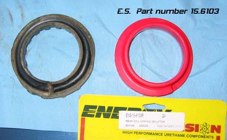

OK I also found some replacement spring dampers (the rubber on the top of the front springs) I thought it would be insane to re-use the old ones with a new set of Eibachs so here is the info for anyone who cares. The part number is 15.6103, and they are ~$11 each from Summit (available in Red or Black) they have approximately the same dimensions and I have test fit them on the crossmember and they fit well. Here is a pic so you can see what they look like next to the old stock ones.
