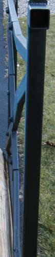

Report this Post05-19-2002 10:50 PM Click Here to See the Profile for FierobruiserSend a Private Message to FierobruiserDirect Link to This Post
Here are two pics I have of a convertible frame. One head on and one side view. Sorry I don't have any dimensions.
This sold for about $750 on ebay sometime last year.

I just emailed you a couple of sketches and the pic from California Convertible's installation guide. How do you guys send pictures??

Been following this thread very closely, pics are awesome!

Bob uses his own design for the sub frame support.
can't the subframe be bolted in place so that is can be removed if access to fuel tank is required? i.e. weld tabs to the fiero frame to bolt the xframe to. Or am I missing something really obvious here?
