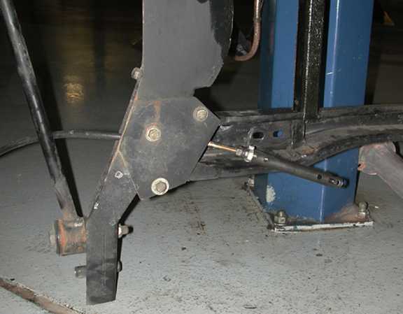

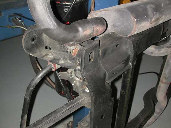

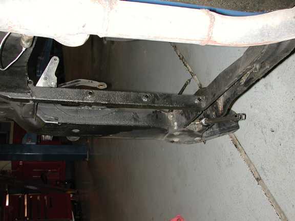

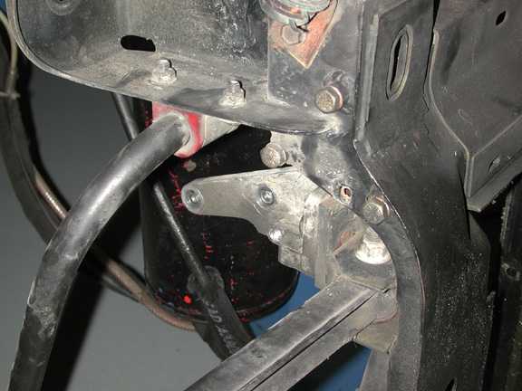

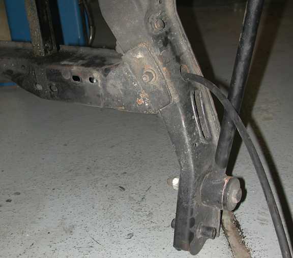

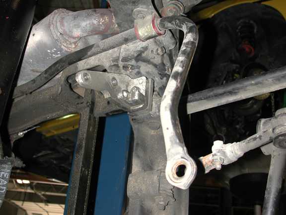

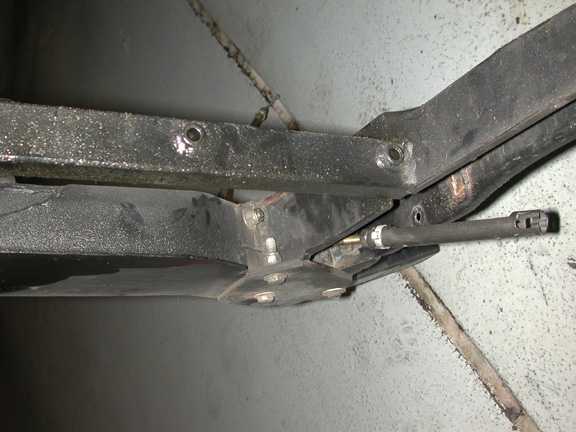

For the brain-stormer mechanics:
California Kid
Posts: 9541
Total ratings: 274
Report this Post07-26-2002 07:00 PM Click Here to See the Profile for California KidSend a Private Message to California KidDirect Link to This Post
This design will allow for the left side to be removed alone. The design is proven and has been running since 1993. Please excuse all the grime built up since '93.
[This message has been edited by California Kid (edited 07-26-2002).]

Nice close-ups! I don't suppose you have any more standing back a little (to get the "big" picture?
California Kid
Posts: 9541
Total ratings: 274
Report this Post07-26-2002 07:14 PM Click Here to See the Profile for California KidSend a Private Message to California KidDirect Link to This Post
That's all I have, might get a chance to take some pics once the cradle is installed. That being the case, I'll post some more pics.

Pisa once sold a split cradle for that same purpose, I don't know if they still carry it though.

Is that a Zimalt kiy you are using?

It started out as a Zumalt Kit, but many modications were made to the parts.

i remember that being shown once in a kit car mag. a pisa and/or zumalt design to make clutch changes easier. pretty neat.
