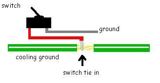

Synthesis, I wanted to ask you a question. I was talking to MinnGreen about this and he referred me to you. Is there a way i can wire in a manual fan switch but still retain the automatic switch incase i forget to turn it on?

Anyways, GTFiero1... Yes...
You have the V6 obviously. On the engine by the filler neck at the top of the engine for the cooling system, you will find a single green wire with white stripe. This wire is a ground for the cooling system. All you need is a single pole single throw switch. (On/off switch) and wire one side to ground, and the other side to the green with white striped wire...
When you turn the switch on, it will kick on the cooling fans in the vehicle. Shut it off, and the cooling system will function properly, assuming you have no faults in any of the electrical systems, or a bubble in the line...
All you need to do is tap into that wire..
It runs through the firewall in one of those harnesses, but don't ask me which one lol.

Report this Post07-25-2002 10:46 PM Click Here to See the Profile for GTFiero1Send a Private Message to GTFiero1Direct Link to This Post
so, it should tie in like this?

As for your car GTFiero1, yes, that wiring thing you did is correct...
Your temp guage is a different sensor entirely, and I suspect the guage may have died on your vehicle (Mine does not work either). The wire you will be tapping into (Green with white stripe) is strictly a temperature controlled ON/OFF switch. It does nothing more than switch on when warm, and off when cold.
The entire circuit is controlled by the key anyways, so you can leave your manual switch on when you get out of the car, and it will still shut the fan off when you shut the key off...
Just be sure to use either a weather tight connector, or use some form of electrical sealant.
