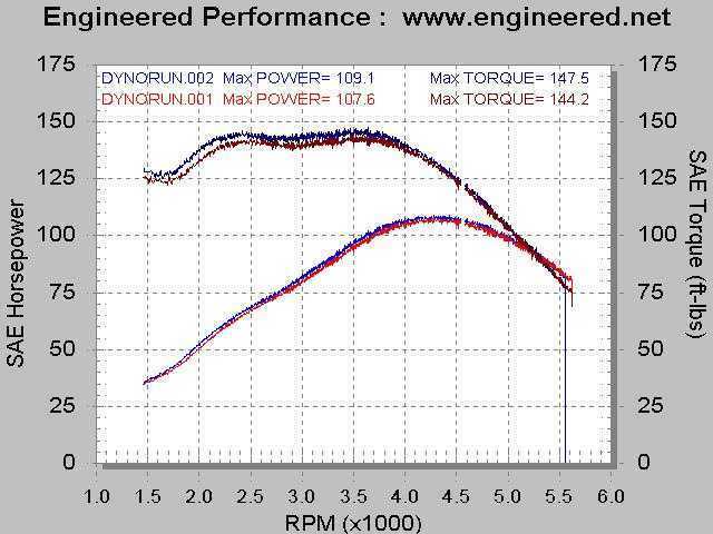

Report this Post07-22-2002 08:42 AM Click Here to See the Profile for 1FST2M6Click Here to visit 1FST2M6's HomePageDirect Link to This Post
Dyno results of a K&N on a stock V6, 4spd... worth it? yes casue you'll never have to replace it... the HP?TQ improvment is just a little added bonus.

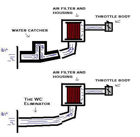

Originally posted by SubZero350:
This design has been proven to be one of the most horrible performing setups available because the incoming air has to change directions many times before entering the intake air tube that connects it to the throttle body. Because of this, I agree that the installation of a K&N filter will show little or no gain compaired to stock.
Actually its one of the best. Ask anyone. There was even a thread on fiero-list@fiero.org mailing list about a book that tested it. The reomved the stock air intake and found no significant gain in HP. I took out my water restrictor the free up the flow a lot and replaced it with just a strait peice of exhaust tubing, but that doesnt even really improve the hp much at all. Pontiac engineers did a pretty good job.
--Adam--
1987 Blue GT 5-speed
IM AOL: GTFiero
SubZero350
No longer registered
Report this Post07-25-2002 02:56 AM   Send a Private Message to GTFiero1Direct Link to This Post
No offense, but I had that same canister filter setup on my 87 GTA and it was the worst thing I have tried. Of course, I tried the usual tricks of removing the restrictive pieces in the air stream but it didn't seem to help much. I narrowed it down to the canister and replaced the whole unit with the aforementioned W-body air box. This was a huge improvement over the fiero-style canister even though it had a K&N. I am currently running a cone filter element because of my CAI design.
Even though this was proof enough to me that my 5.7L wanted more air than what the canister could effectively flow, I am sure that a 2.8L could benefit as well. I would like to see someone who has access to a flow bench to perform some tests and prove us all right or wrong on what's the best setup.
PS: nice diagrams, but I would suggest that you make an adjustment in where the air flows thru the filter...in that the air doesn't just go thru one side of the filter but all around; which i believe causes turbulance that can rob power. Just my opinion.
(If the canister design was so good, why do all the GN, T-type, and Turbo Regal guys get rid of theirs as a first mod?)

subzero350 ... the canister design on the two cars is totally different. Now I am not saying that you are not entitled to your opinion and I'm not saying that your subjective evaluation is not "right for you". And I would encourage you to make whatever legal and safe changes you think is appropriate on your car.
However, your assertion that the design is flawed was a subjective evaluation. There is not a proven improvement (dyno numbers) on any of the modifications that are so popular on the air intake system of the Fiero. In fact, all the tests and evaluations done so far have results that prove the Pontiac engineers did do a very good job of designing an effective intake in a very difficult position with the materials at hand.
That said: Have fun with your car.
Thank you for the info but I am afraid you are not entirely accurate with the information you presented concerning the air filter housings:
1. Both the 2.8 fiero and TPI Firebird / Trans Am's use the same part number air filter (you can look this up at autozone.com).
2. The only major difference in the canister design between the two cars is how the air flows thru the unit. In the Firebird, the air flows out of the center of the canister...while in the fiero the air flows into the center of the filter element.
In any case, I still believe this setup does not promote the most free flowing air intake stream that can be attained while using any filter element.
As I stated before, goto turbobuick.com and ask most there who have "fast" cars as to if they believe your air filter setup is the best or not.
Again, no flames intended and I welcome your and any other person's opinion. I have not seen any actual dyno or test data concerning the fiero's stock air filter setup so if you know where I can find this info, please enclose the URL with your next post.
