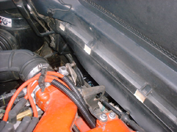

It is possible that the bushing in the TB is bad and causing the plate to bind in the bore.
Here are some pics.....best I could do. Hope it helps.
