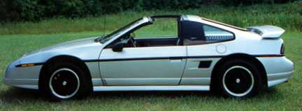

Originally posted by mrfiero:
Other parts are interchangeable, although I have seen some really funky looking T-Tops......possibly some early production ones or ??, but they are missing the rear fill moldings on the roof (glass panels are bigger!). I'm sure this set-up shares very little to the "normal" T-Tops.
I wish I had a pic of what I'm talking about, but I don't.
I believe this picture shows what you are talking about.
84SE w/ T-Tops
That's it! I have seen one of these and for the life of me I don't know what it is. Was this some sort of pre-production or early C&C effort or ??
99.9% of all Fiero T-Tops have the rear fill panels and the smaller glass......I'd like to know some history on the set-up in the picture. Anyone?
Thanks for posting that.
