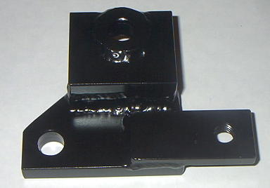

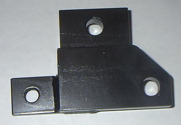

I now have steel brackets allowing the 88's to retain all the 88 A/C parts for use on the 3.4. You previously had to use the 85-87 V-6 A/C parts and weld in a bolt to the cast iron bracket. My new bracket allows you to use the 88 A/C parts.
