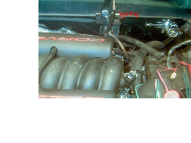

How do you remove deck lid spring safely without breaking anything??? My problem is the deck lid spring hits my engine covers... If the deck lid won't stay up afterwards ( which I am guessing) I will put in a strut

I saw that pin but the spring goes in front of it??? I was wondering if there was some trick? I have thought of cutting it too.

I got it I tapped the pin back about a quater of an inch... Cut the head off, and pulled it through with a vise grip. Spring still in one piece... Just in case I am un happy with the results. I will have to check that link above... See what I did wrong LOL. It does make quite a pop even if you are ready for it.
Hmmm a rope to pull it back, then slide the pin out.... I knew there must be a trick ... Good article. Thanks to all that helped

I redesigned the mechanism so that it does not interfere with the engine but is still funtional. Every other 3800SC I have seen has not been able to use the torsion bar.

Hey skitime do you have a picture of that by any chance... I am very interested. As you can see in the pic of mine it would have to go on the other side of the hinge. Here is another question if anyone knows. There are three holes. If I put the pin in the back hole would it be strong enough to hold up the lid? I have a wing and white springs( my thoughts are probly no).

With the decklid removed and the limit straps broken (my setup ) the spring can be unbolted from the hinge with no excitement. With the engine out, I bent a tab on the hing mount, then slipped a piece of pipe over the end of the spring, bent it down, moved it toward the rear of the car past the tab I bent, then let it back up. Nothing fancy.
