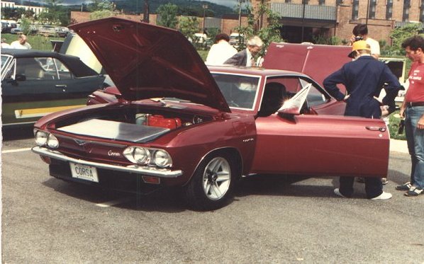

They are expensive motors to build , We have a 4.0ltr version int he back of a corvair. TRW forged pistons , balanced ,ported , polished , bigger chevy rods , you name it , it's been done. but all at a hefty price. I also have a buick 3.5ltr version sitting ont he garage floor.
The starter is on the wrong side , this can be swapped with some machine work. There is a guy on the Corvair list putting a Fiero Cradle int he back of his vair , along with a getrag mated to a Rover (olds) v8
Like I said , there expensive to get power from , but there lighter than a 2.8 by 40Lbs.

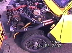

Report this Post05-18-2002 03:53 PM Click Here to See the Profile for PKSend a Private Message to PKDirect Link to This Post
Hehehe this one amused me:
Back to the books.
Cheers
PK
[EDIT]: Yep its a mini!
[This message has been edited by PK (edited 05-18-2002).]
